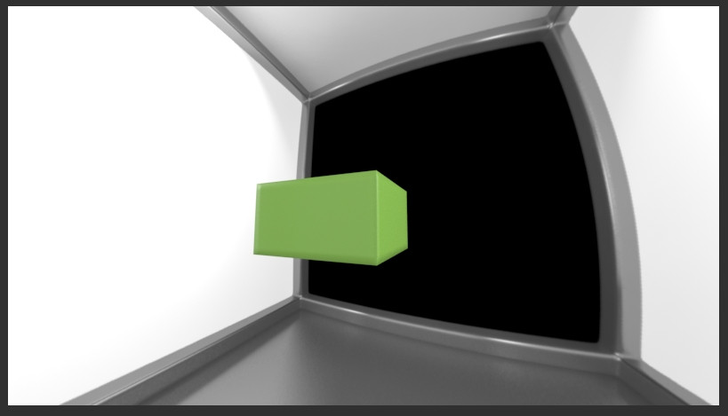

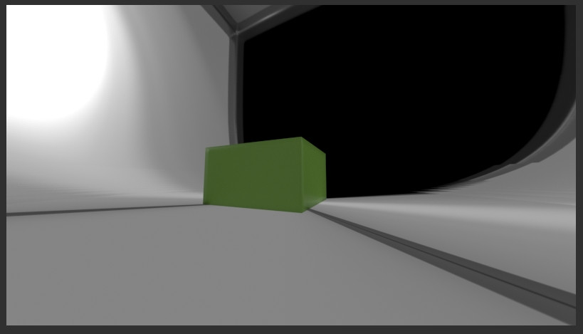

                  Peter.Chaushev It's still not working, the ground feature cause strange distortions. Attached a Rhino example scene file.
                  dome light
Name:	Screen Shot 07-21-23 at 10.47 AM 001.jpg
                  real sphere
Name:	Screen Shot 07-21-23 at 10.47 AM.jpg
