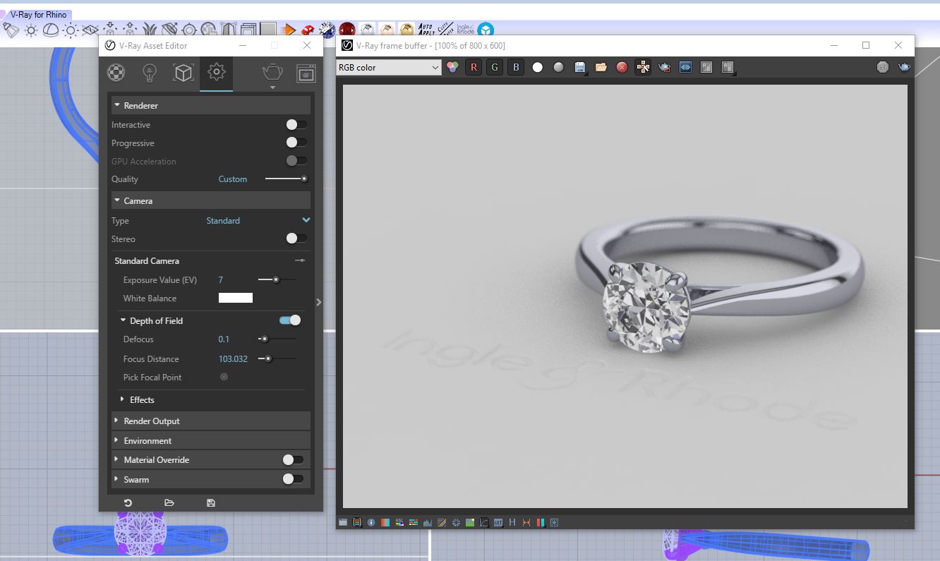

Exposure change with DOF
@Aaron Clark,
This is a side affect of using a Physical Camera with a short focus distance. The best way to address this would be to use a focal length between 100-200mm and dolly the camera out further. This would simulate an actual setup a photographer would use with jewelry.Best regards,
