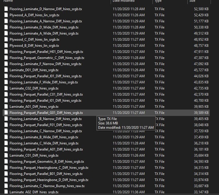

                          The Vray materials .tx, files are huge 16-50mb for wood etc. See screen grab. Is that part of problem?
                          Did I download a high resolution library when low(er) resolution would be fine for my work?

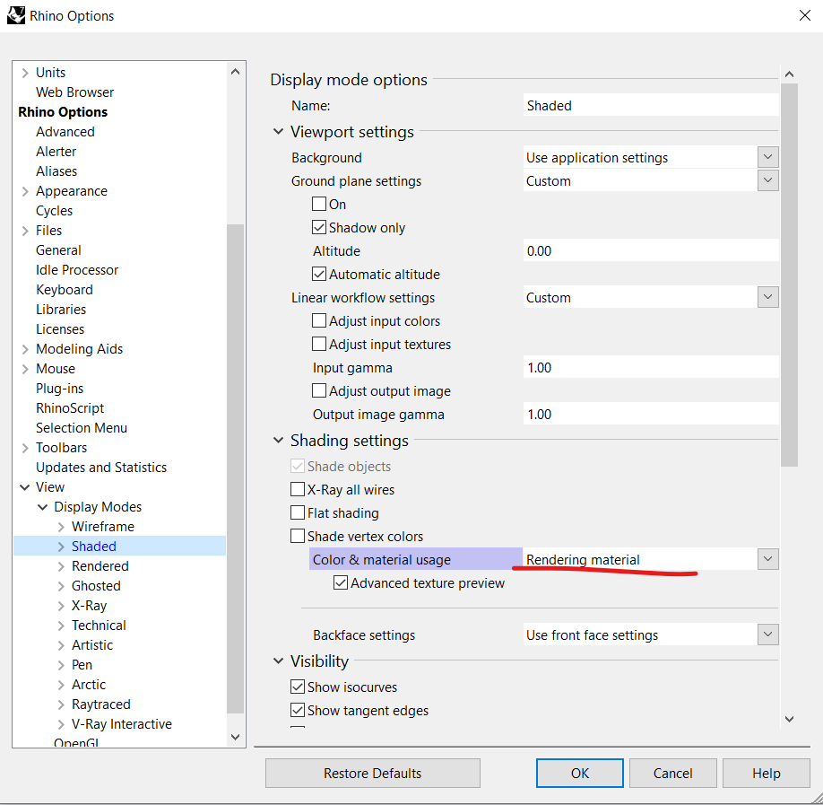

                            Please go to Rhino options > View > Display Modes > Shaded and change the Color and material usage to Rendering material. Then you should be able to see textures in the Rhino viewport.
                            Click image for larger version  Name:	Screen Shot.png Views:	0 Size:	69.8 KB ID:	1114689
                            Note that some materials may still not be visible in the viewport. This is because Rhino’s viewport does not support procedural textures. In that case you can use the Binding option and set your own texture for the viewport representation.

                              thank you for the reply.
                              I am already using that setting, and I understand procedurals won't display in Rhino.
                              The problem with textures not displaying is related to the size issue mentioned above & ticket 339-328-4987  
