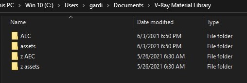

      Thank you for the reply, yesterday I figured out that was part of my problem, so I temporarily renamed the asset folders C:>users>gardi>documents>V-Ray Material Library AEC & assets as "temp AEC" & "temp assets".
      Started rhino, opened Vray asset editor and let the material library download.
      Then made a test file, with significantly smaller file size when using wood, grass, etc.
      I opened my current projects, file size reduced from 56mb to 20mb and vray materials displayed correctly.
      So for now this is working.
      When things slow down for me, I'll take a look at your library link and compare to what I downloaded.

        P.s. I haven't downloaded the low resolution files from Slavcho, will that get overwritten by newer Vray assets, sending me back into the same large file loop? Or can I somehow name the folder to avoid that?
        Vray 5.10.04
