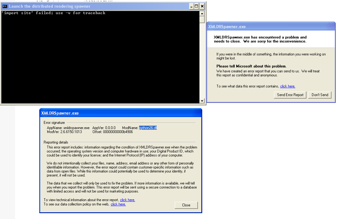

          Hello Micha_cg
          I tried to install Vray for Rhino 5 x64 on XP machine without Rhino installation and I got the following error when I started the spawner.
          Could you please confirm if you have the same error on your side - or the error is different.
          Thank you very much.

          • #20
            Fantastic, you got it!!! That is it.

              Hello again,
              This happens only on XP operating system - On windows 7 you can use Vray without any Rhino installation.
              I'll report this issue to our developers - and I'll inform you when there is a fix to this bug.
