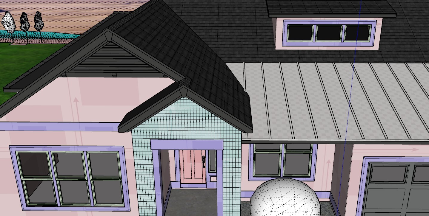

Vray Texture helper ate my Sketchup texture image
This topic has been answered.
  • Vray Texture helper ate my Sketchup texture image
    Vray texture helpers have replaced my actual textures - re-writing the links to the original bitmaps.
    This makes it difficult for me to adjust textures unless I live raytrace at the same time.
    Anyone know why this might happen?
