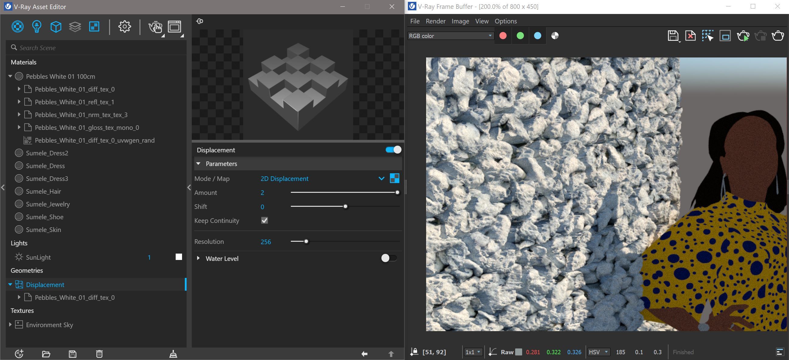

    I am trying to add displacement to a grouped object, but no matter how hard I try I cannot get it to work. I have tried to remove materials, re-add material, remove displacement and re-add etc etc. But still cannot make it work.
    I have looked at the tutorial and followed each step but still no luck. Would there be anything I am missing to not get this working correctly. (My old materials with displacement are still working okay)
    This was just using one of the new cosmos materials in a basic scene with a cube and flat plane. Any help would be greatly appreciated,

        Hi AMG445,
        As it's mention in the other thread you have to add a displacement texture.
        The material you've downloaded doesn't come with a height map but it can still kind of work if you use the Diffuse or Reflection texture:
