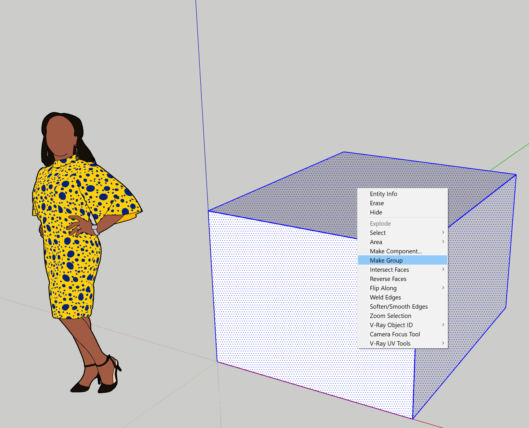

              1) Create an object and group it (making a component also works

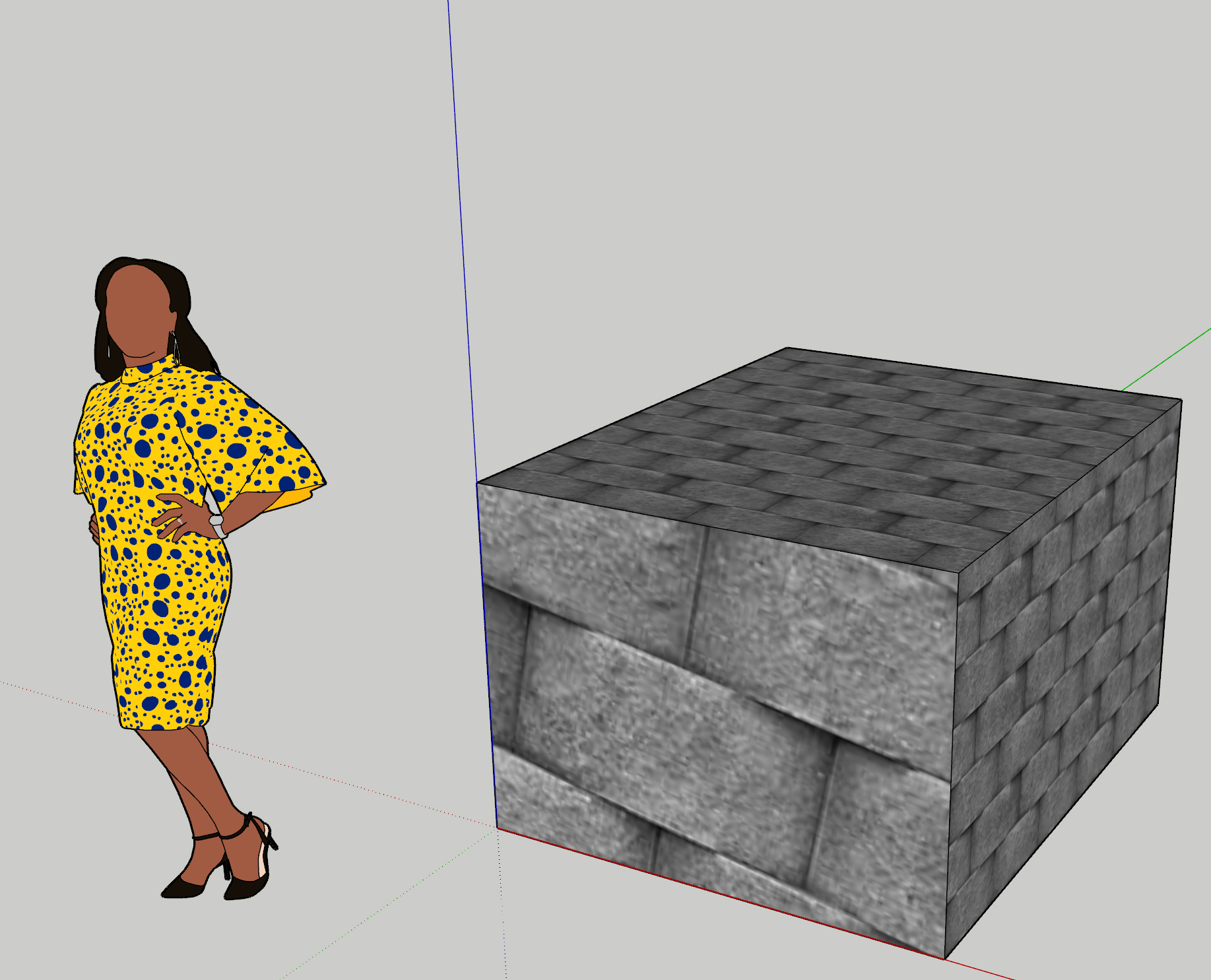

              2) Create a material and apply it to the faces of the object
              Click image for larger version  Name:	tp_02.jpg Views:	0 Size:	1.53 MB ID:	1145761
              3) Manually change the texture placement
              Click image for larger version  Name:	tp_03.jpg Views:	0 Size:	1,006.9 KB ID:	1145759
              Click image for larger version  Name:	tp_04.jpg Views:	0 Size:	742.2 KB ID:	1145758
