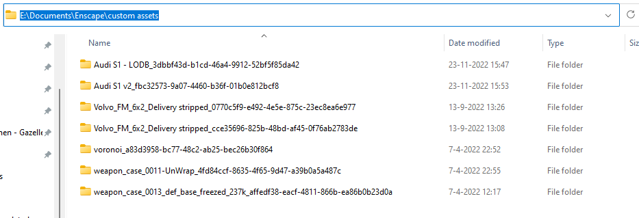

      The location of my custom assets is E:\Documents\Enscape\custom assets\ where E:\Documents\​ is actually the 'My Documents' folder but I don't like it on C for backup reasons.

      That custom asset directory you only set once, the first time when you create a custom asset in Enscape and the value is stored in CustomAssetEditorSettings.json located here C:\Users\<user name>\AppData\Local\Enscape.
      Code:
      {"ProjectDirectory":"E:\\Documents\\Enscape\\custom assets","OutputDirectory":"E:\\Documents\\Enscape\\custom assets"}
      Maybe V-Ray can just check for that specific OutputDirectory value in the Enscape file and a lot of it is solved (or I might think to straight forward )
      I'm just testing/playing a bit and let me know if you still can use some example but I think it's just a path-thing after digging some more.
