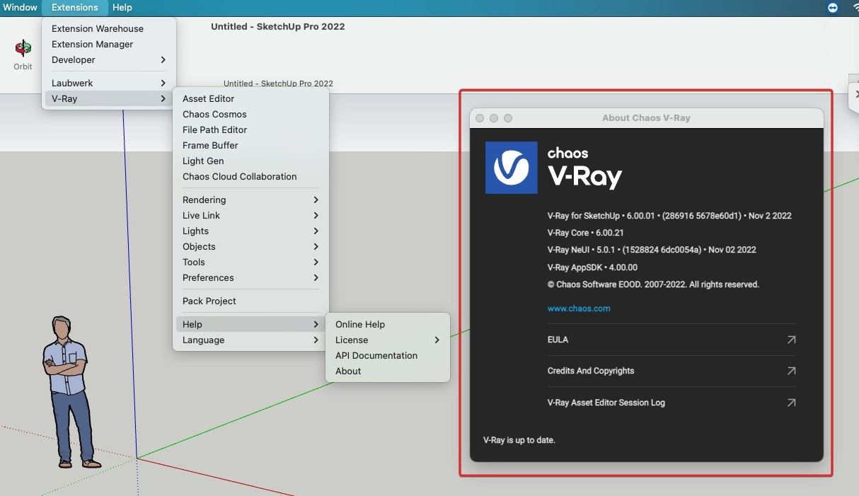

      Could you please share some more information in order to investigate this issue:
      • Please share a screenshot of the About V-Ray window to determine your V-Ray version.
      Click image for larger version  Name:	V-Ray_About_SU_MacOS.jpg Views:	9 Size:	123.3 KB ID:	1175209
      • Can you specify the steps that you perform before getting this error message, so we could try to reproduce it on our side.
      • It would be most helpful if you could try placing an Infinite Plane in a new empty scene and check if it renders correctly. If it still does not work send us a short video recording to understand the process.
      Alternatively, please open a ticket so we could arrange a TeamViewer session so you would be able to show it directly.
      Thank you in advance.
