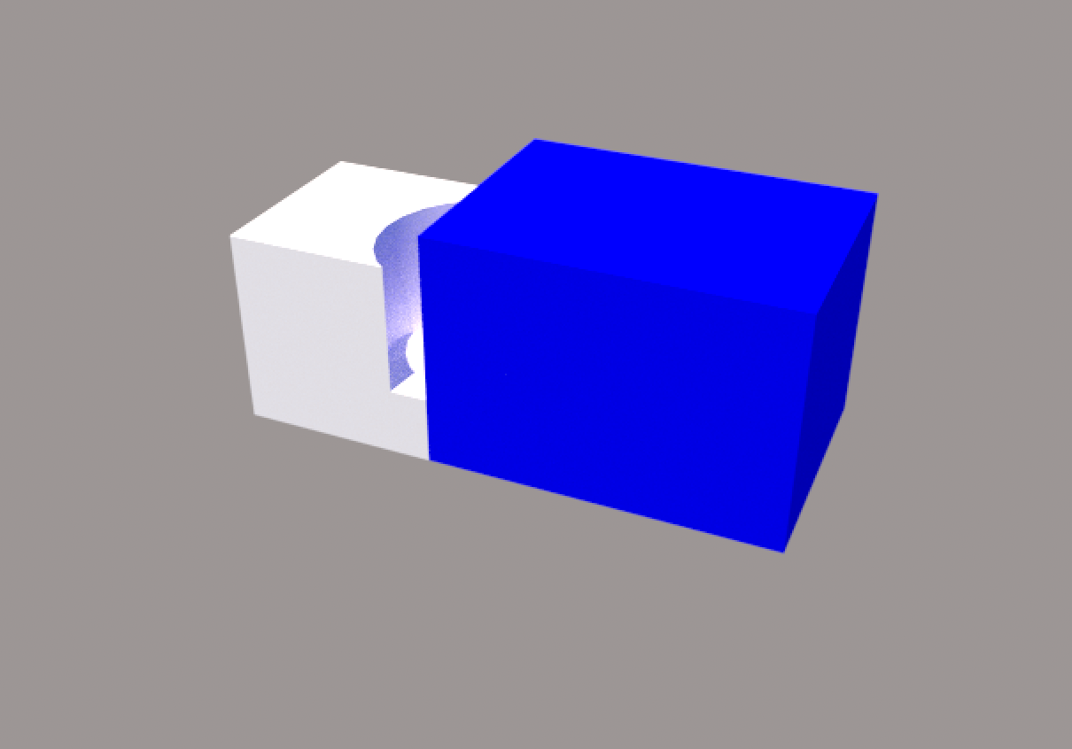

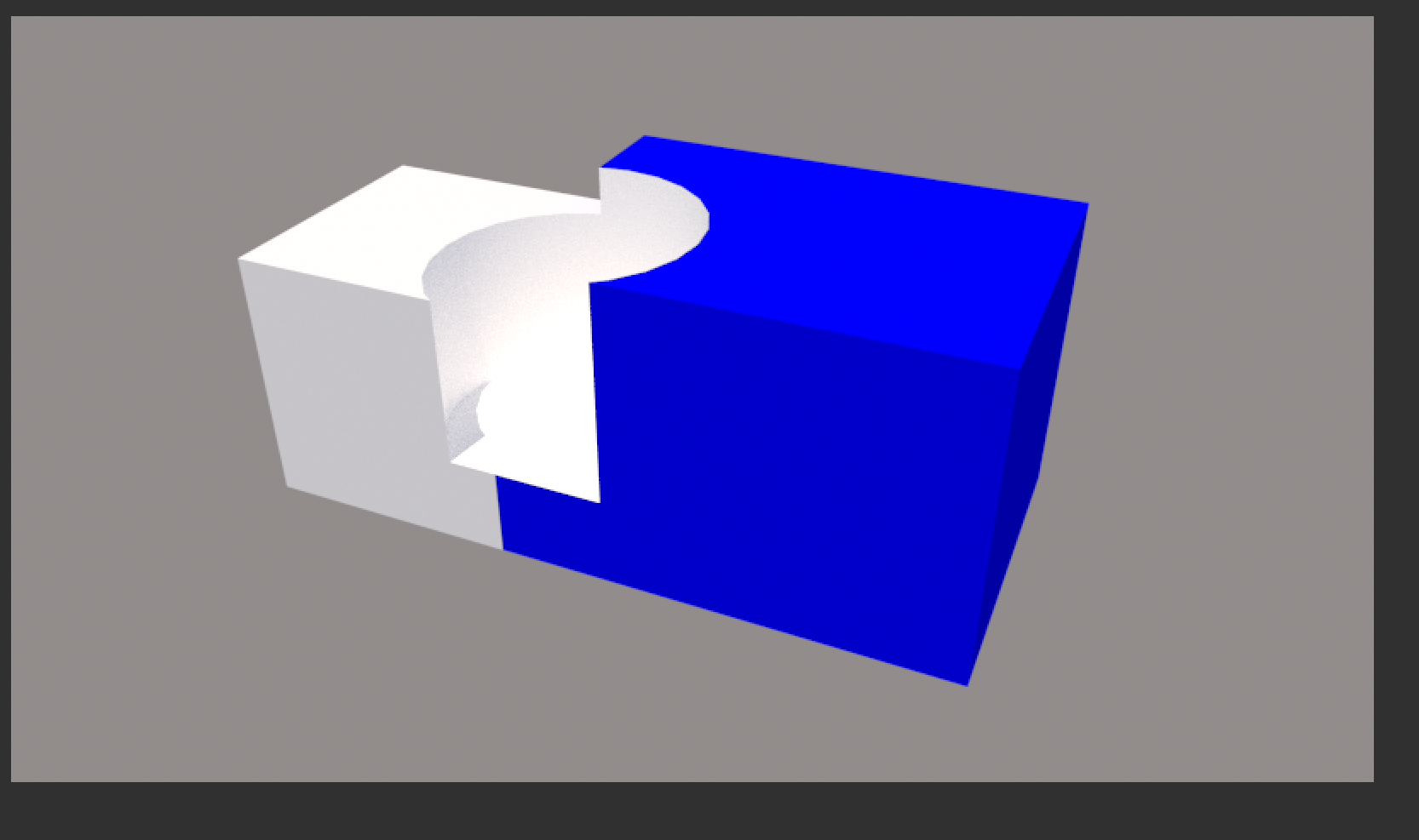

      Thanks for the reply Natalia. Sorry, I didn't make myself clear in the op. I have a component with a clipper nested into it. I save it to the library. When I bring it back into the model I would like the clipper object to cut through other object/components. This doesn't work unless you cut and paste the component with the clipper back into the model. I've attached a model for you to look at.

        Thank you jkollars66 very much for new examples and clarification.
        Actually what you describe is expected and it does not matter if the Component with Clipper is saved in the library and then imported back into the scene.
        When you make a Group or Component with specific objects and Clipper only those objects that are included in this Group/Component will be clipped. Please see the video example.
        This is done specifically so that you can have more control over which objects to clip and which to ignore.​
        So you are correct that you need to either explode Group/Component in order for Clipper to clip everything or place objects inside of the Group/Component with Clipper.
        Natalia Gruzdova | chaos.com
