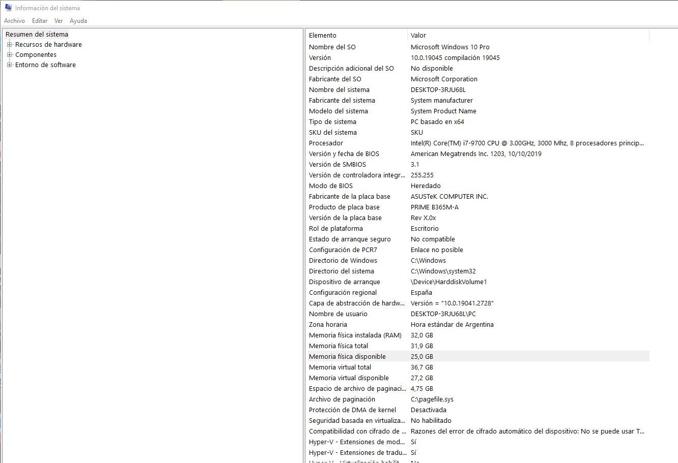

    • Are you rendering with a CPU render engine? Please run a V-Ray Benchmark and share your score. Also in terms of memory please share how much Available physical memory you have. It can be checked in the System Information tab (example).

      - Available physical memory: Attached image
