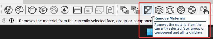

    You may need to remove the material from all faces before applying it again to make it work correctly, you can use a Remove material tool from V-Ray toolbar:

        Hello Natalia, thanks for the reply, i just tryied end it worked, but first i had to remove the material as you suggested. I will try with the decals also, as i've seen in the other topic.
