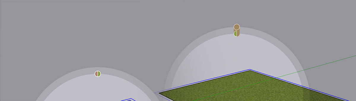

          The Random color does not work for meshes that have the front and back faces painted with a different materials.
          One of the materials can also be inherited from the Group / Component - it's still a problem.
          To find such situations in the scene you can use the Scene Interaction Tool.
          The following 2 examples will cause issues:
          You can sort of work around that by making sure that both front and back faces use the same material.
          Note that a default material assigned to the back will not cause the problem - it's handled differently by V-Ray.
