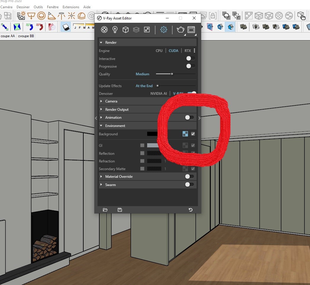

    did you uncheck the checker on the environnement settings?
      this box...
        Thank you! Do you mean to clear that checkered box? When I uncheck the background the checkered box still is blue. When I click on the blue box and clear it my window is still black? I have other rooms I am working on and when I compare all settings this room still has black window? So confusing? Not sure what I am doing wrong? Got any other advice to try??
