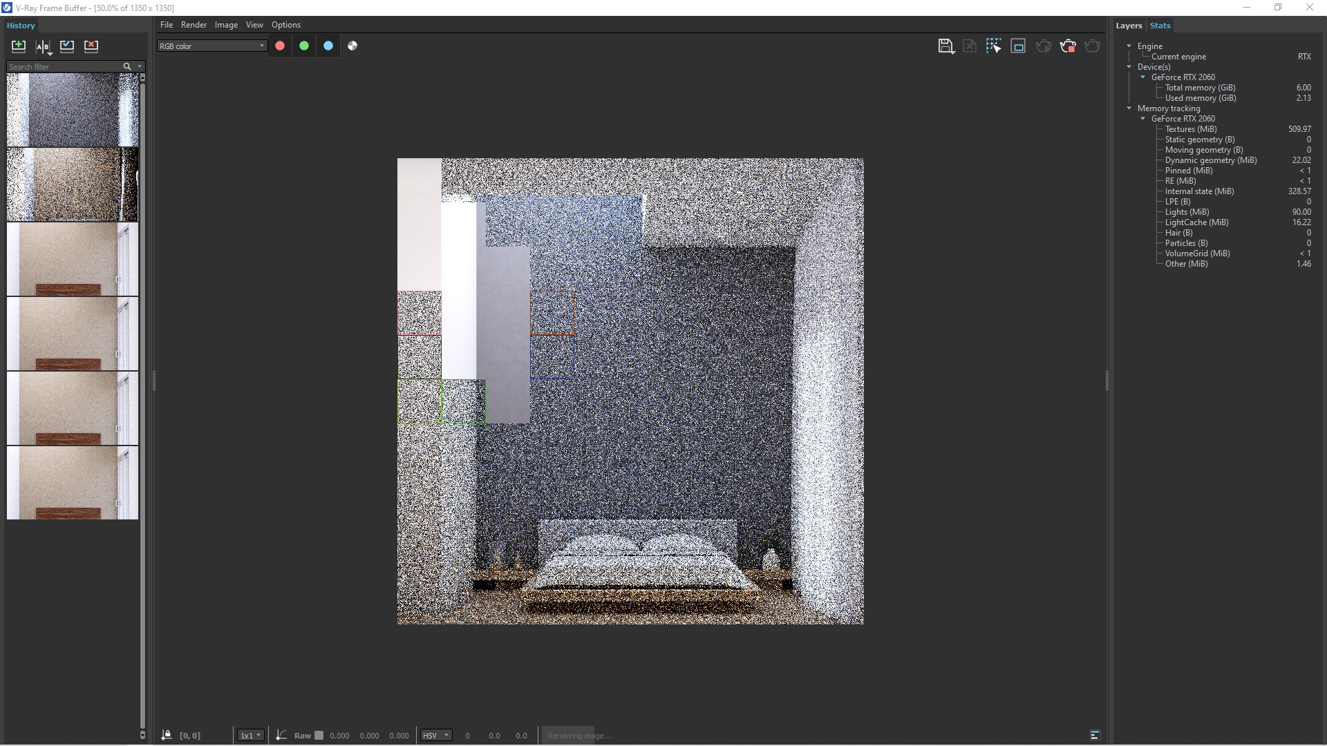

    I'm facing really long render times for a simple scene. I'm not exactly sure why but I did notice the attached comment in the bottom of the VFB.
    Is there anything that I'm doing wrong?

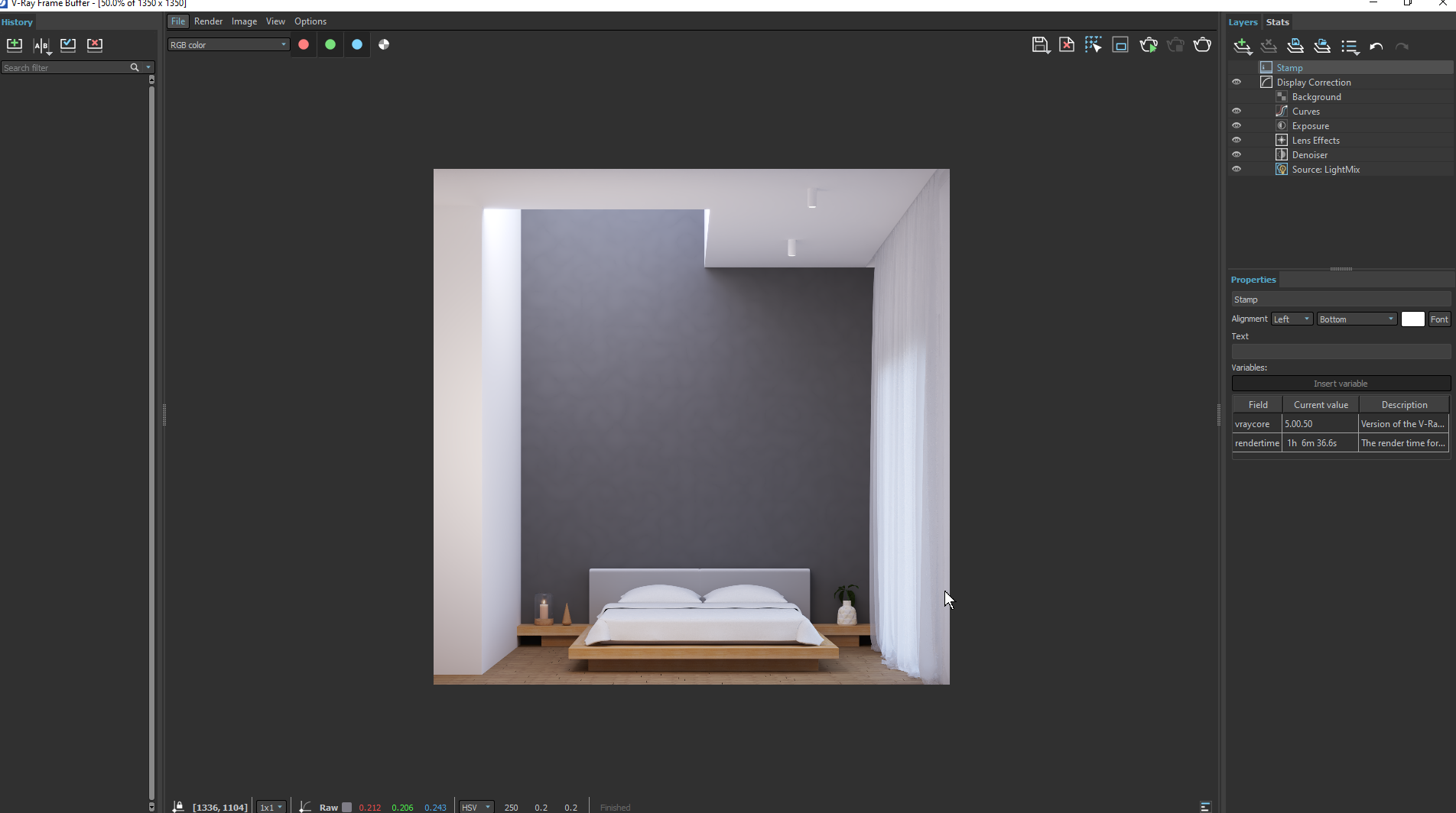

    Attaching some more screenshots. I tried both CUDA and RTX but with no luck.
    It's really frustrating to wait a long time for a simple render scene.
    I also cleared all additional geometries, lights and more. But the render time hasn't improved a bit.
      It took me more than an hour to render this scene.

        Regarding the warning you're seeing, this has been discussed here. It is intended only for developers - it appears on heavier scenes that tightly occupy GPU memory and means we would've liked to have a bit extra memory. It shouldn't worry you.
        I've noticed that you are using Full-size textures, maybe changing GPU Memory Management to On-demand mipmapping would prove helpful. See here: https://docs.chaosgroup.com/display/...moryManagement
        Regarding the long render times, I checked the project file you shared and it looks like this is due to the render setup.
        Keep in mind that if you are using high-res textures and high quality setup, it would be expected for render times to get longer.
        That being said, we've prepared a great article on the subject - Render Settings Explained - Quality vs Render Time, which you can check out and see what fits you best.

          I have improved my render time dramatically and I think I'm going to make a youtube video for this so that it helps others as well.
