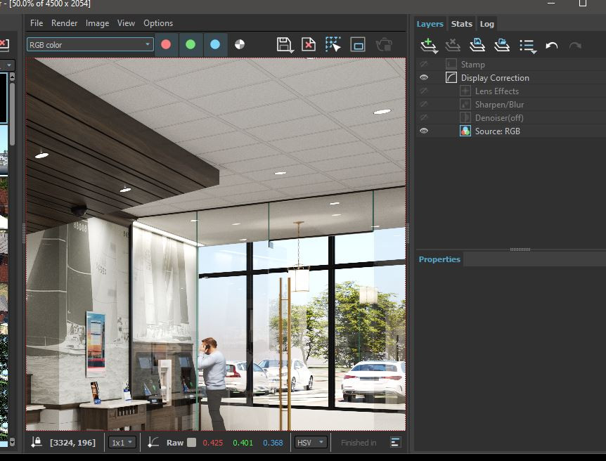

                            Just downloaded a file I rendered with Lightmix enabled, with Chaos Cloud, saved as multi layer EXR, and opened in VFB - no Lightmix. Am I missing something?
Name:	EXR LightMix.jpg
                            Matthew Valero, ASAI
                            • #15
                              Ok, I solved it. I was not saving with multi-channel check box turned on even though when you save EXR you do get all the channels regardless of whether the box is checked, but I assume some other things happen under the hood when it is enabled. This is good to know! Thanks.
