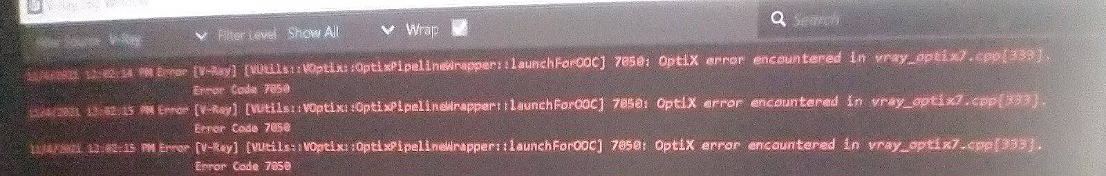

                    Hi Muhammed
                    I really like this update and thanks so much to vray Chaos team, i know You work hard to bring us the most excited features.
                    I did a test right now with update 2 and vray gpu light cache only gives me a vram problems and a crash, i did 6 test with the same scene ( update 1 ) renders fine, but vray gpu light cache doesnt work, takes too much vram, i turned off vray fur and vray displacement and still doesnt work, i didnt try the other features... I can't render... I did a test with a second scene it failed again, don't know what is happening vray gpu with update 2 takes too much vram
                    Thanks Muhhamed

                        Hi Muhhamed
                        Let me do a test with brute force + brute force Vray gpu with light cache with buckets and progressive didnt work Muhhamed takes too much vram, i'm very excited with this new feature and i would like to conserve update 2
                        Im going to make another tests to see what's happening, but seems vram problems, fills very quickly the vram
                        Thanks for the fast feedback
                        • #13
                          I did a test brute force + brute force is the same Muhhamed, didnt work, did a test with cuda both on progressive and buckets didnt work, then changed to a very light scene it didnt work only gives crashes, right now is imposible to render a scene with update 2 vray gpu
                          • #14
                            When it crashed, it crashed very heavy You can't Even return to sketchup, You can't turn off vray or sketchup i have to turn off My computer, with this new update vray gpu crashes so heavy that makes My work station almost in a freeze stage
                            • #15
                              Can you update your driver to 496.14
                              You need to restart the machine first, then install driver, then restart and test V-Ray
                              This might be an issue with GPU drivers, let me know if this works
