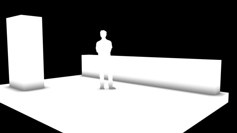

          Another thing to consider is the background.
          The ExtraTex element will render the background black...
          ...while the AO element will treat it as something unoccluded
          Konstantin
