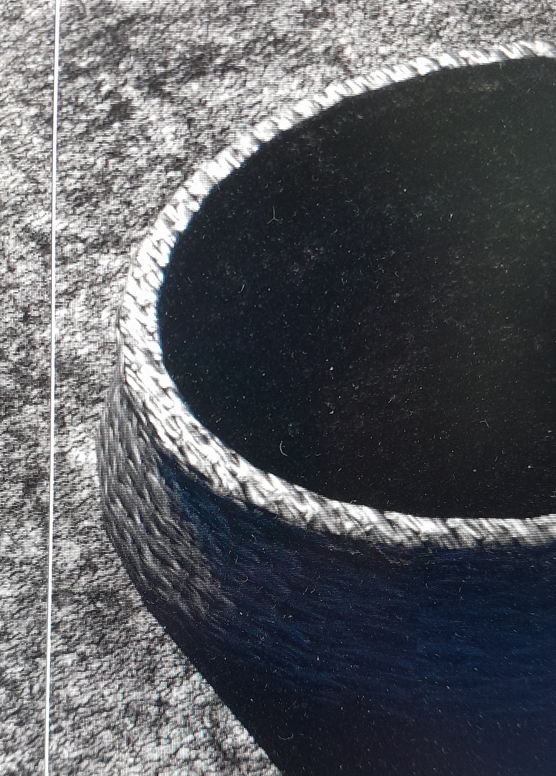

              Another example
              Click image for larger version  Name:	20221129_151738~3.jpg Views:	0 Size:	1.71 MB ID:	1166590 left normal map without invert green channel of normal map, right normal map inverted the green channel.
              The right does not have the kind of Tiny holes that the left already has.
              Vray did not change automatically it took as it comes again, so invert the green chanhel is necessary, right now im doing it with the notmalmaptex that you give me Konstantin it works, but the render region does not lie to anyone... the green channel has to be inverted in order to get a nice normal map.
