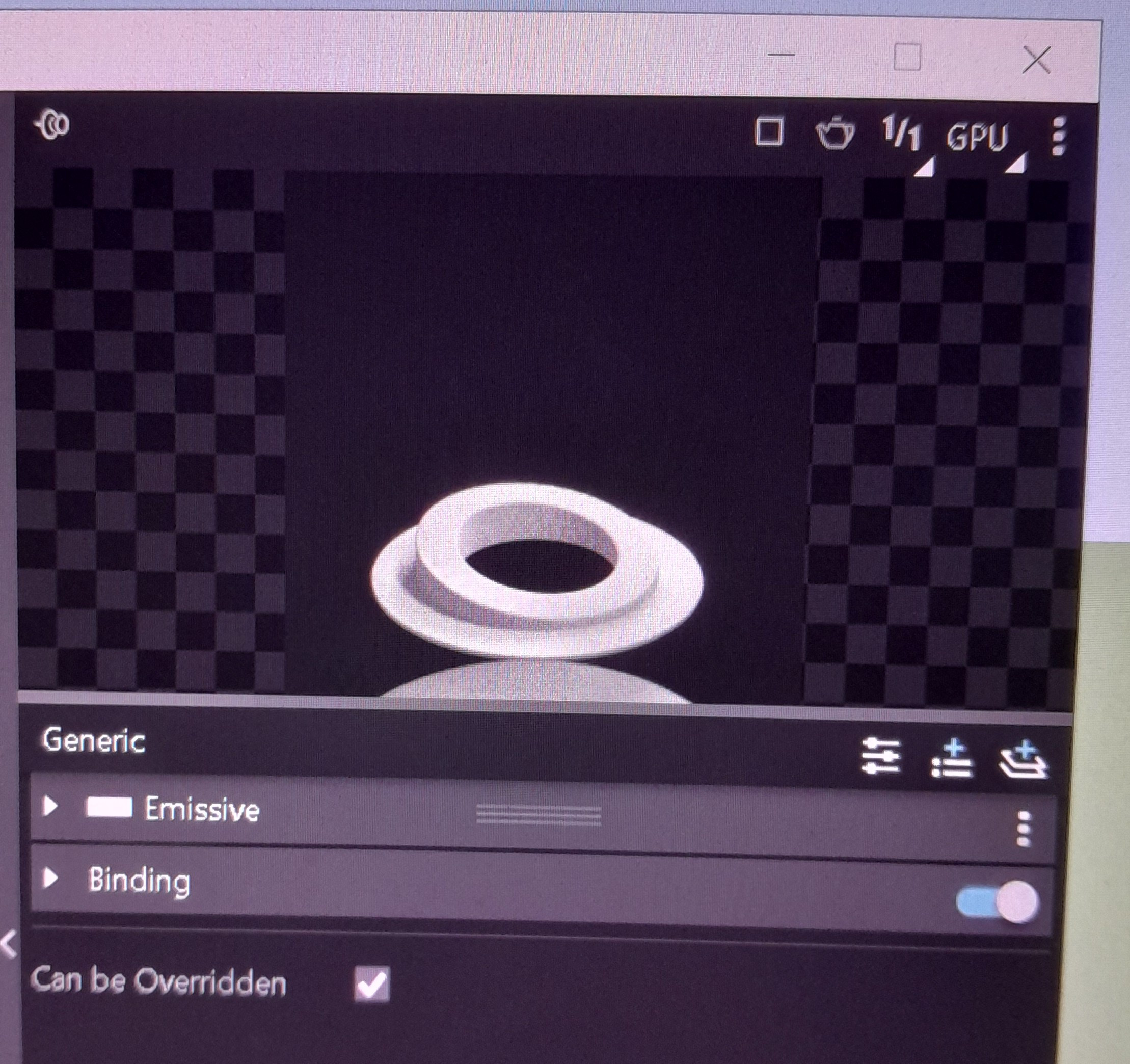

      Click image for larger version  Name:	20230823_005536~2.jpg Views:	0 Size:	1,015.5 KB ID:	1189088 Here it looks perfect, vray cpu
      Click image for larger version  Name:	20230823_005547~2.jpg Views:	0 Size:	914.5 KB ID:	1189089 Here this material does not work with vray gpu
      This is not aceptable and it is very very frustrating.
      This is becoming a nightmare...I cant believe this with vray gpu!!!
      The other half is crucial for that material, without support for vray gpu this flame and this material does not work with vray gpu

          Hi,
          The emissive material is supported on V-Ray GPU.
          I just tried a simple setup and it works for me:
          Another thing I added in this project is a Omni light in the middle of the flame.
          The Omni light shadow radius was increased to soften the shadows.
          Note that you can set up a similar material using the Generic material's Self-illumination properties.
          Konstantin
