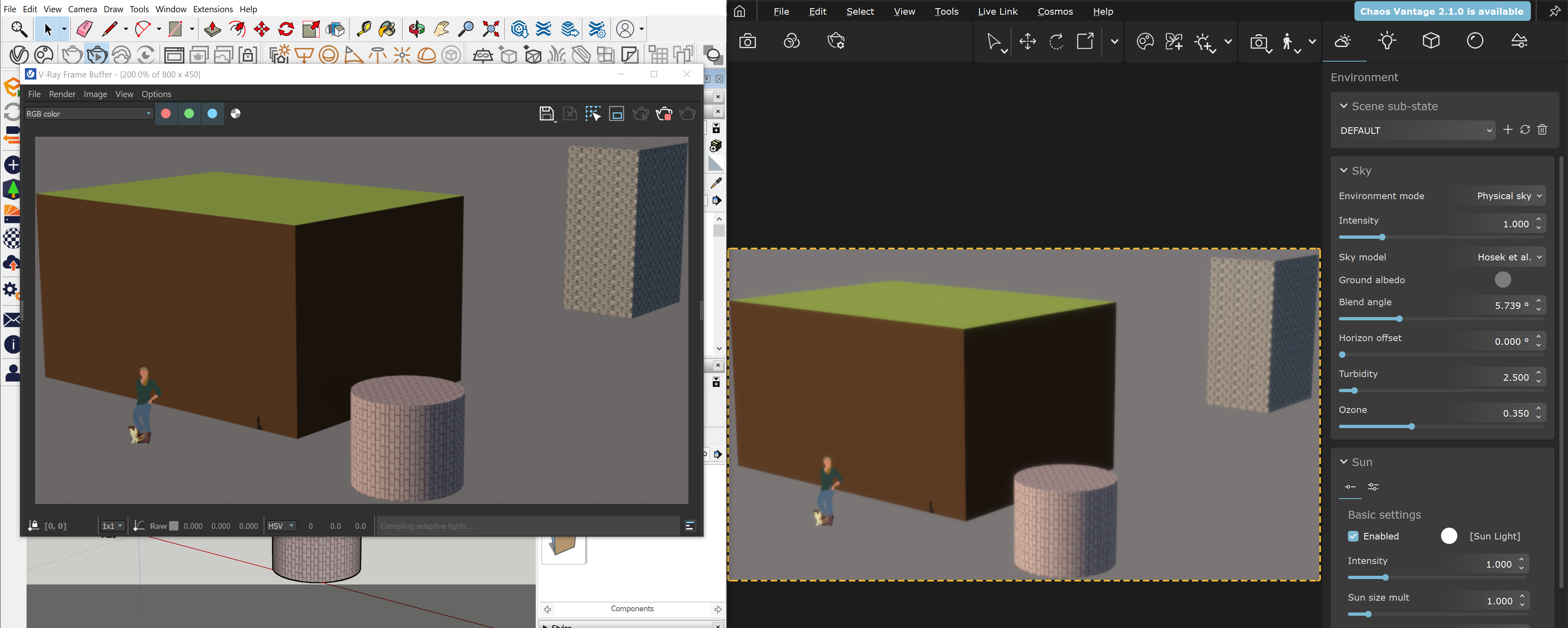

    Hi,
    In my tests it seems that Vantage is matching the active SketchUp camera:
    What I did was:
    • ​Enable safe frame in SU
    • Export a vrscene
    • Load it in Vantage
    • Make sure that the aspect ratio that Vantage uses is the same (HD in my case)
    Can you describe your setup so that I can give it a try?

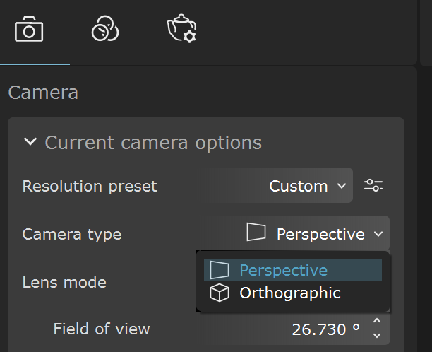

      Using live-link setup up a 2-pt camera in SketchUp that uses panning and zooming after turning 2-pt camera on. Vantage doesn't seem to recognize the pan and zooming done within SketchUp, which is something that a V-Ray camera can do within SketchUp. I would like exports from Vantage to match sketchy and hidden line views from SketchUp exactly. I asked the Vantage team in the forum and they said this is on their list of things to do at some point.
      Matthew Valero, ASAI
        Now, that is the reason.
        Currently, there is no such option in Vantage and hence matching your viewport would be impossible.
