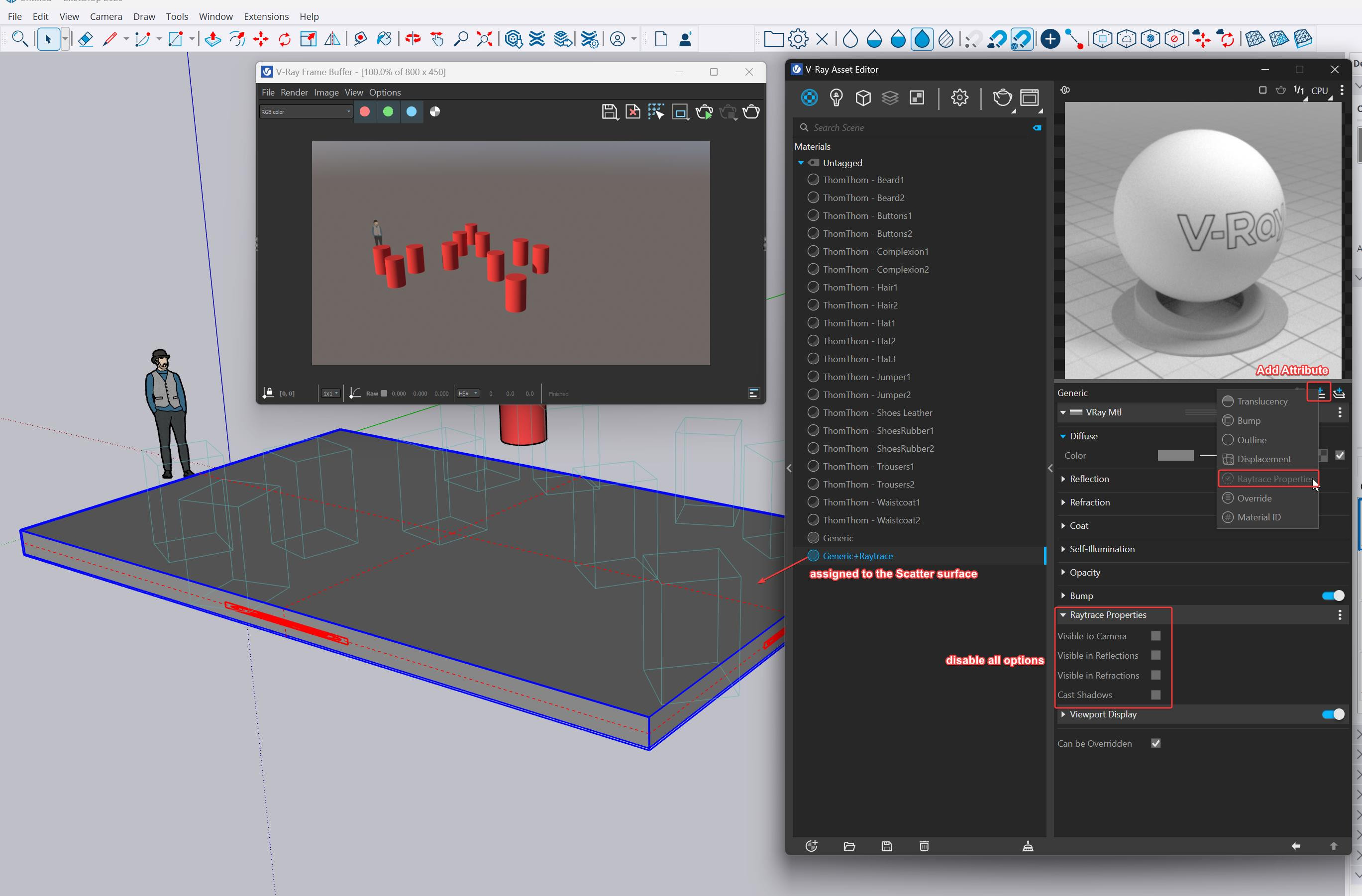

        In V-Ray for SketchUp you can assign a material to the surface with Raytrace Properties Attribute. Disable all options so that objects with this material will not be rendered.
        Here is an example.
        Natalia Gruzdova | chaos.com
          It is working-thank you.
