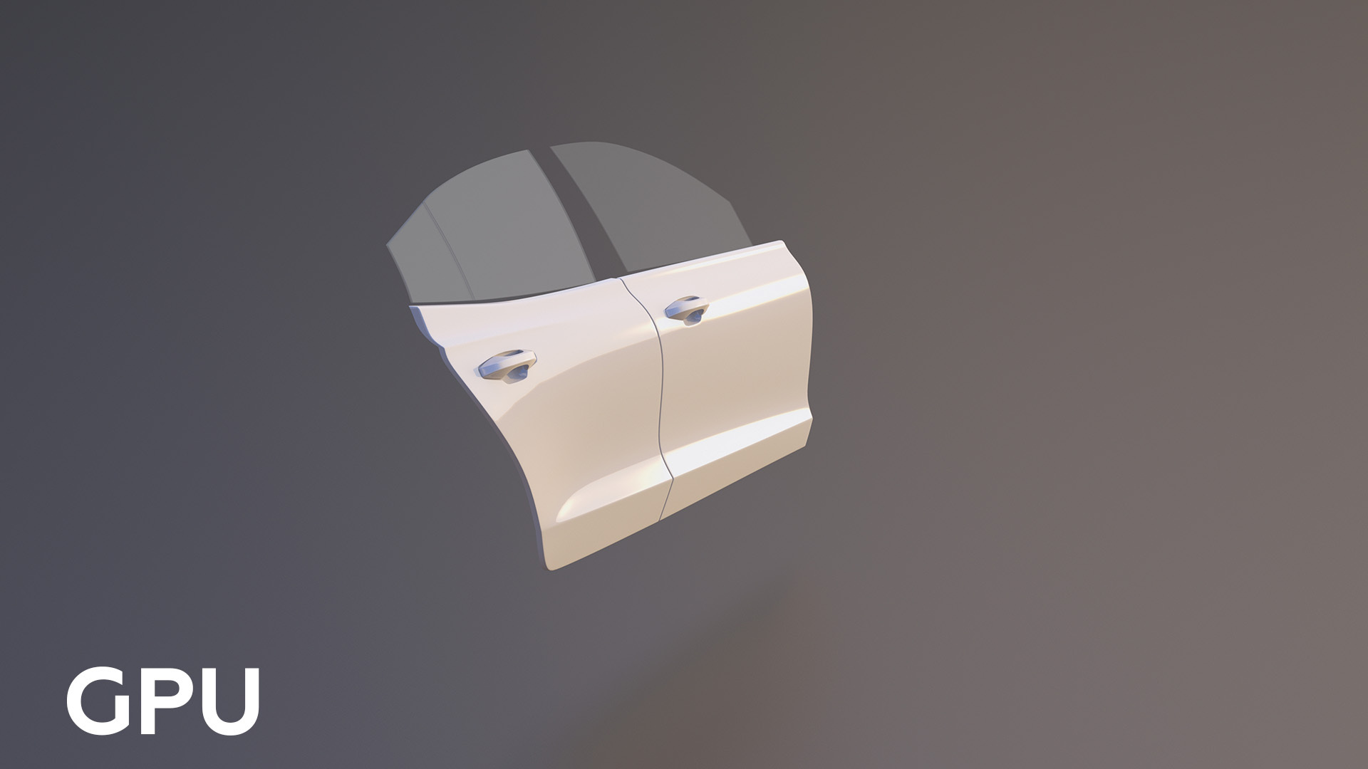

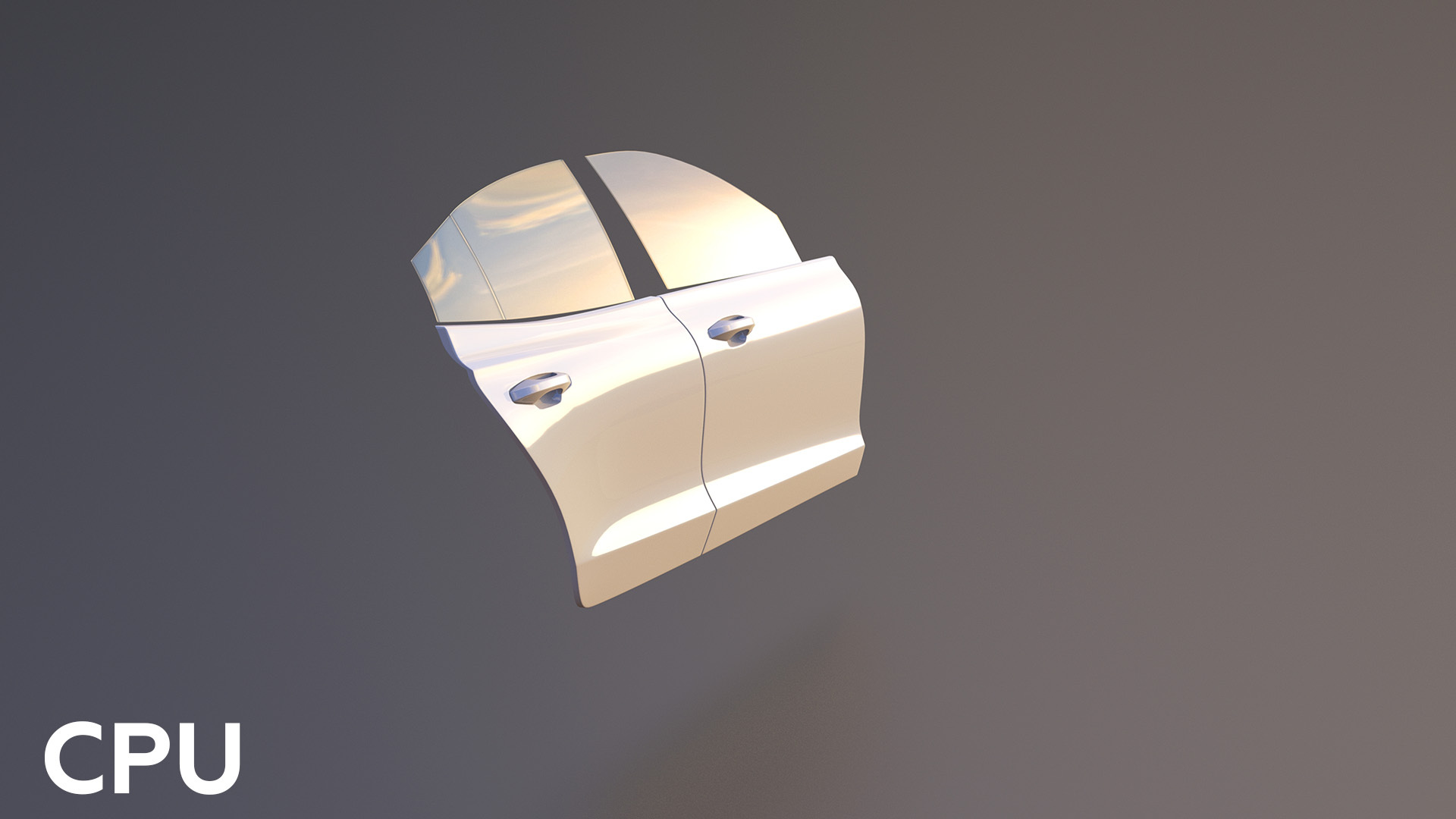

    I am not certain if I'm testing correctly on your previously provided scene. Could you attach (or send it via the contact form addressed to me in the subject, with a link to this thread in the message) a simplified version of your current one?
    Hey Aleksandar,
    Thank you for your assistance! I have created a ticket.
    I'm posting the scene files and renders here as well.
Name:	Vray_CPU_ Reflections and Lighting.jpg
ID:	1105269Click image for larger version
Name:	Vray_GPU_ Reflections and Lighting.jpg
    Kind regards,
    Olie
    • #17
      This is an issue on our side. It's logged under (VGPU-5340). For now, as a workaround use the Adaptive mode of the Light Evaluation feature.
      Zdravko Keremidchiev | chaos.com
      • #18
        Dear Zdravko!
        Thank you very much!!
        Disabling "Subpixel mapping" in color mapping and switching Light Evaluation to "Adaptive" in overrides, solved the issue.
        Image from CPU and GPU looks the same, however the render times are significantly faster on GPU
        Kind regards,
        Olie
