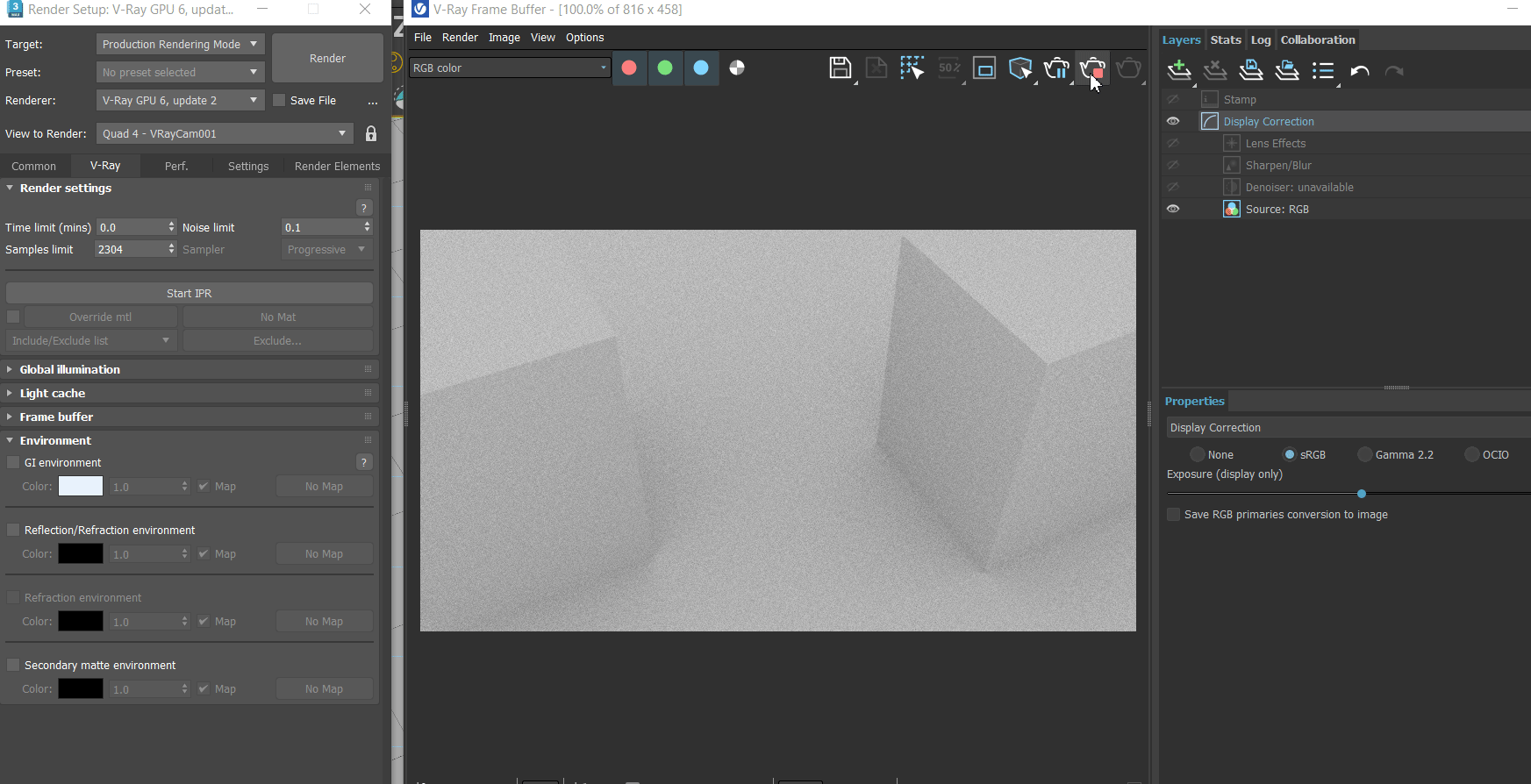

        This is how it works on my end:
        If the above does not help please proceed to test a simple scene on your setup and let us know how it goes.
