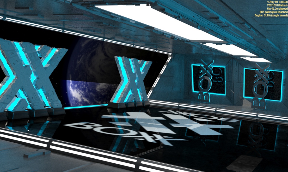

    hi, I have had some difference between cpu and gpu,why?
    sorry for my poor language
    thanks for help
Name:	default setting_CPU.jpg
ID:	880956Click image for larger version
Name:	default setting_GPU.jpg
    The texture blurring is probably because of the "Rescale textures for GPU" option and turning it off should make things closer.
    For the strange darkening at the window - I'm not sure, it would be best to get us a scene to support@chaosgroup.com
    Vlado

      Now, I send to you a scene
        I've tried it, but the problem remained
        thanks for help
          Try going to texture bitmap setting and setting up texture blur from 1.0 to something like 0.001
            Actually these are ignored on the GPU.
            Vlado
