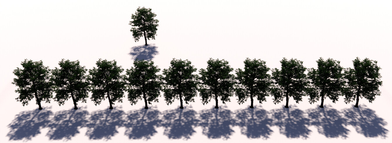

However, sometimes, having this “locked” at a type level isn’t ideal (use case example: appearance and size swap-outs of more-commonly instance-based items like trees)
Switching/employing the parameters in a family on an instance-basis doesn’t appear to be recognised by Enscape - and I was wondering if this could supported please?
