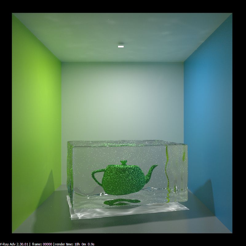

                            Some more fun with the BDpathTracer. I'm a bit surprised with the variance still left around the teapot.
                            • #74
                              Looks cool, but what's with the black attachment?
                              They are caustics seen through glass, so that's somewhat normal. The next major version of V-Ray will deal with this.
                              Vlado
