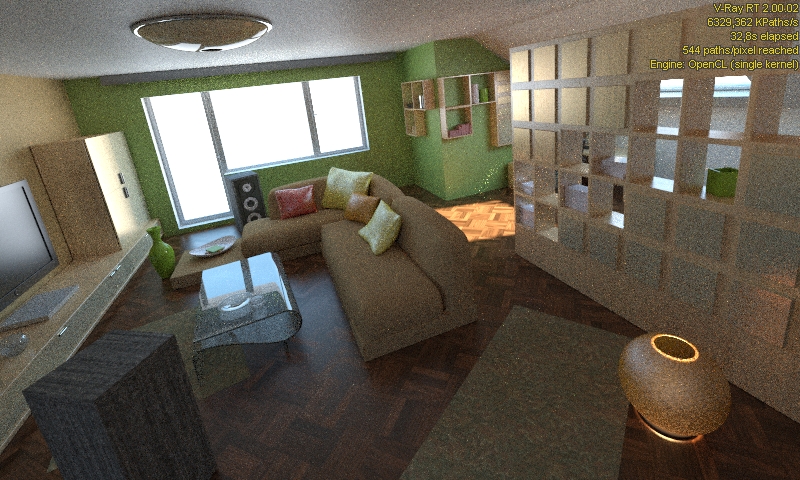

32,8s with 6 GTX580 .
1 cubix xpander Desktop2 + 1 cubix xpander Desktop 4
No DR at all, all cards are plugs in my workstation .

Nice setup. Which exact 580s are you using? Could you do some tests with some GPUs disabled? Would be interesting to see how it scales with 2,3,4,5 GPU.
4 zotac and 2 pny .No one is overclocked is already really hot and i'm trying to make them cooler .
with only 1 580 someone have say : 2min42s
With 3x 580GTX i have : 1minute
With 6x 580 i have : 32sec
With 9x 580 but some on Pcie8X instead of 16X i have : 27sec. This test isn't very good, i will trying with all cards in 16x later.
It's nearly linear when you see that with 1 card you are near to 3minutes. 3 cards = 1 minutes and 6 card near to 30sec .
