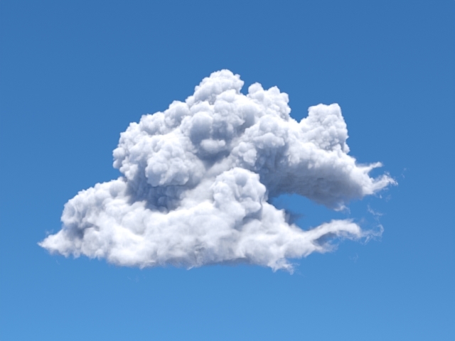

                      Starting off with Georgi's scene, I got this:
Name:	cloud phoenix 3.11.jpg
                      This is with a build from yesterday, here is the scene as well: Clouds_scattering_Max2016.zip
                      The highlights for this kind of shading include:
                      - Use Probabilistic Shading from Phoenix's Atmosphere - 8 direct samples, 1 GI sample.
                      - BF/LC GI, progressive sampler, Ray bundle size = 8 for more responsiveness.
                      - Phoenix light cache off - it's better to turn it off with progressive.
                      - scattering = Ray-traced
                      - smoke color = pure white - this way light scatters the most
                      - simple smoke opacity = 0,13 - the lower this is, the longer distance the light rays will travel before scattering, but if it's too low, the smoke would lose its shade detail.
                      I think mostly everything else is using defaults.
                      Currently there is no scattering phase function in the Phoenix shader, which would allow you to get the dark edges of the cloud.
                      Cheers!
