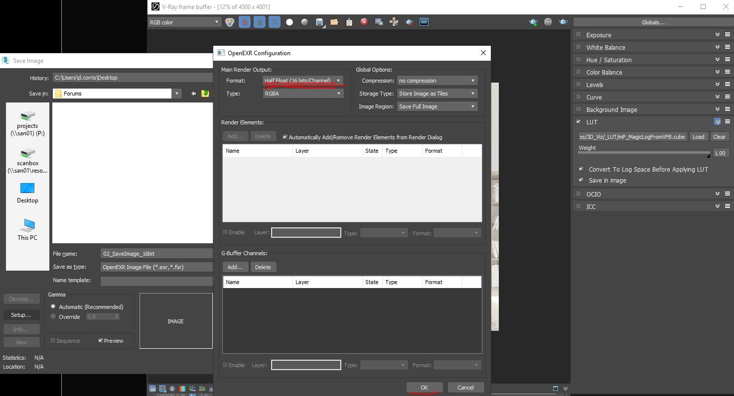

        Sorry I may not have been clear. See attached start to finish (VFB->PS)

            just skip the back and forth gamma jump and 32 to 16bit PSD conversion. save from VFB to non-hdr format, 16bit png or tiff. render goes right into 16bit PSD via smart object/video layer and saved time can be used for something more productive than clicking buttons in photoshop.
            any particular reason for exr here?

            • Thanks. Really appreciate your input here.
              Originally posted by piotrus3333 View Post
              sort of ok.
              you saved exr with gamma 1.
              Can you elaborate on this? I understand the difference between 1.0 and 2.2, but saving it out on 'Automatic' is 2.2 right? I would have to override it to 1.0. But if its on automatic, its 2.2? I may have my wires crossed here.

                  automatic gamma during saving to hdr format like exr gives you 1 not 2.2.
                  1 = linear and 2.2 = ~srgb. hdr formats are always considered to be gamma 1. its pointless otherwise. exr in pshop looks ok because it gets view transform to srgb. for ps all hdr formats are 32bit psd, no way around it.
                  linear color simply put gives you ability to add and subtract render elements. add and substract operations in ps. in srgb this is never works correctly (hence your overlay mode, read on that)
                  now if you are totally ok with 32bit psds than nothing I suggested here is for you (just drop the overlay mode, use add/subtract for vrayreflections element)
                  16bit tiff never gave you the hdr data because the values got clipped at 1 float. log space takes all the hdr data (above 1 float) and squeezes it into 16 bit 0-1f range. this is still a lot so you can recover it with curves in 16bit psd.
                  you get the hdr-like range in 16bit psd. you loose benefits of linear color.
