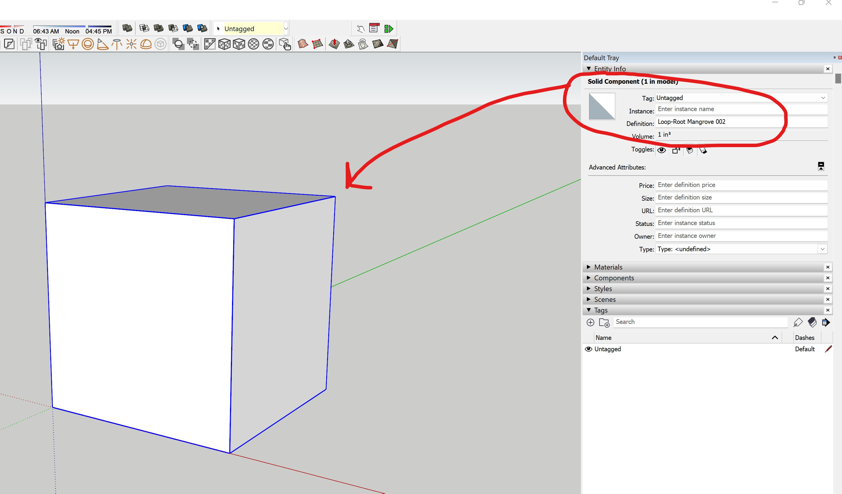

    So I noticed in my renderings that the leaves of a Cosmos asset (Loop Root Mangrove 002) was seemingly not rendering right. So I thought, probably mistakenly, that I could simply browse to the assets directory and delete the asset folder (under 3D_Models/Vegetation...) of the problem asset. I did this without realizing that there is a delete asset option that can be used directly from the cosmos interface. I tried using this method to delete the asset after I deleted it manually and got the message as shown in the "Problem Asset Delete" image attached. So, when I went to reload the asset, I only got a small 1in cube in my model when I tried to reinsert it. (see "Problem Asset Cube" image attached) Also, when I go to other files with this asset, that particular asset doesn't render in those files either.
    Not sure if it helps to troubleshoot this, but I've also included a screen shot of what I see in my Asset Editor when I click on the problem asset...see "Problem Asset" image....there is a red check mark instead of a green one...I intuitively understand what a red check mark means - I assume it means that there is a problem with the asset - but there doesn't seem to be a way to click on it or or right click on it to rectify the issue....
