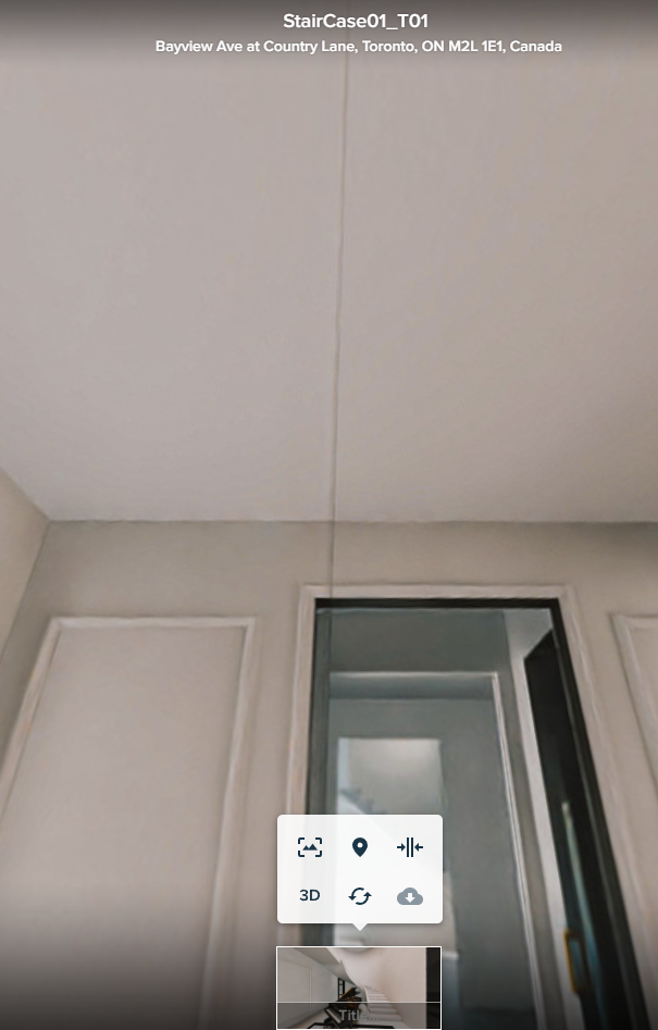

            Hello,when I using spherical mode I have a seam in final production,How Chan I Fix This

                Hi amir_asgari ,
                Sorry for the late reply. This seam is caused by the AI denoiser. Can you try and render the panorama without the denoiser enabled? This should fix the black seam. I will log it in as an issue and we will investigate it further for a fix.
                  I reported it two years ago and the problem still exists. Please don't forget to fix it. The Nvidia Denoiser is a nice tool, but ... .

                    Hi Micha,
                    Have you tried with the Intel Open Image Denoise instead of the NVidia one?

                      No, not tried yet and I hope it works. I know that the V-Ray denoiser works. Only it would be nice if the Nvidia denoiser could be fixed for this issue too.

                        This problem has been brought up on the forum a couple of times but we don't have a scene to reproduce it with. If you can share a simple scene where the Nvidia denoiser produces a seam, it would be helpful in the future when testing if new versions of the denoiser have solved this issue.

                          npg Here is a stripped down project file - it was a train interior. It's a Rhino3D file, but I also saved the scene as OBJ, maybe it's easier for you to check. Simple white environment, Cuda mode, progressive, noise limit 0.05, Nvidia denoiser.
                          Here how it looks at Rhino. Good luck.

                          • #14
                            I'm still unable to reproduce this. What viewer are you using, is it the VFB panorama mode or something else? What is the render resolution? What is the nvidia driver?

                            • #15
                              npg This is the VFB panorama mode, but I get the black stripe at every viewer. The resolution is 2000x1000 but I get the stripe at higher resolution too. The driver is 536.40. Attached a vrscene file. I don't know how to save a vantage file. I could open a support ticket and the support team could read the Rhino file.
