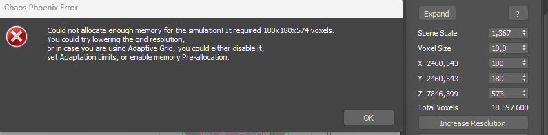

                                Still struggling with the scene. I wonder if the latest update broke something, because simulation eats up all the memory. I'm running this on my secondary workstation with only 32 GB of RAM. I think I have relatively coarse resolution. Is there anything I should try?
