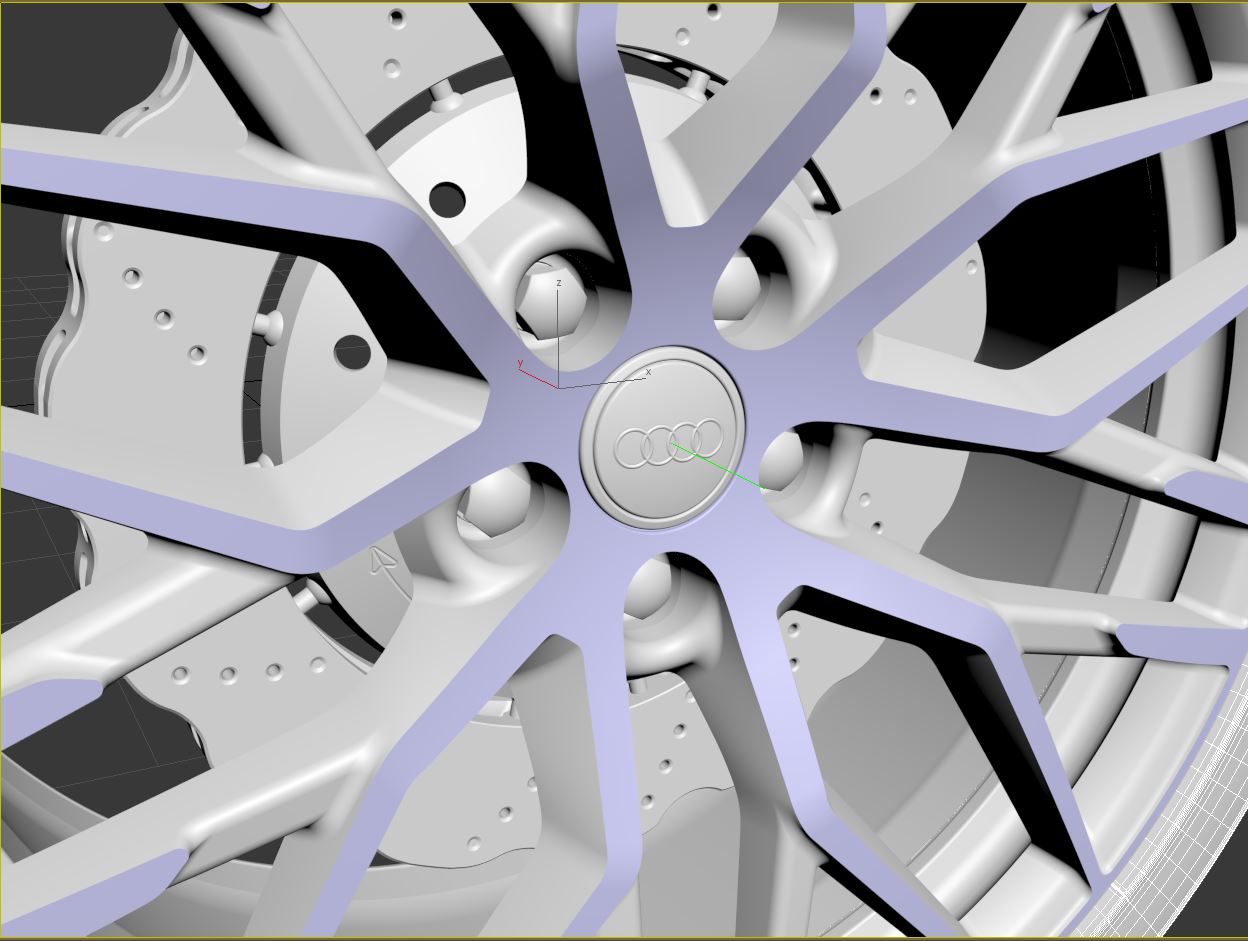

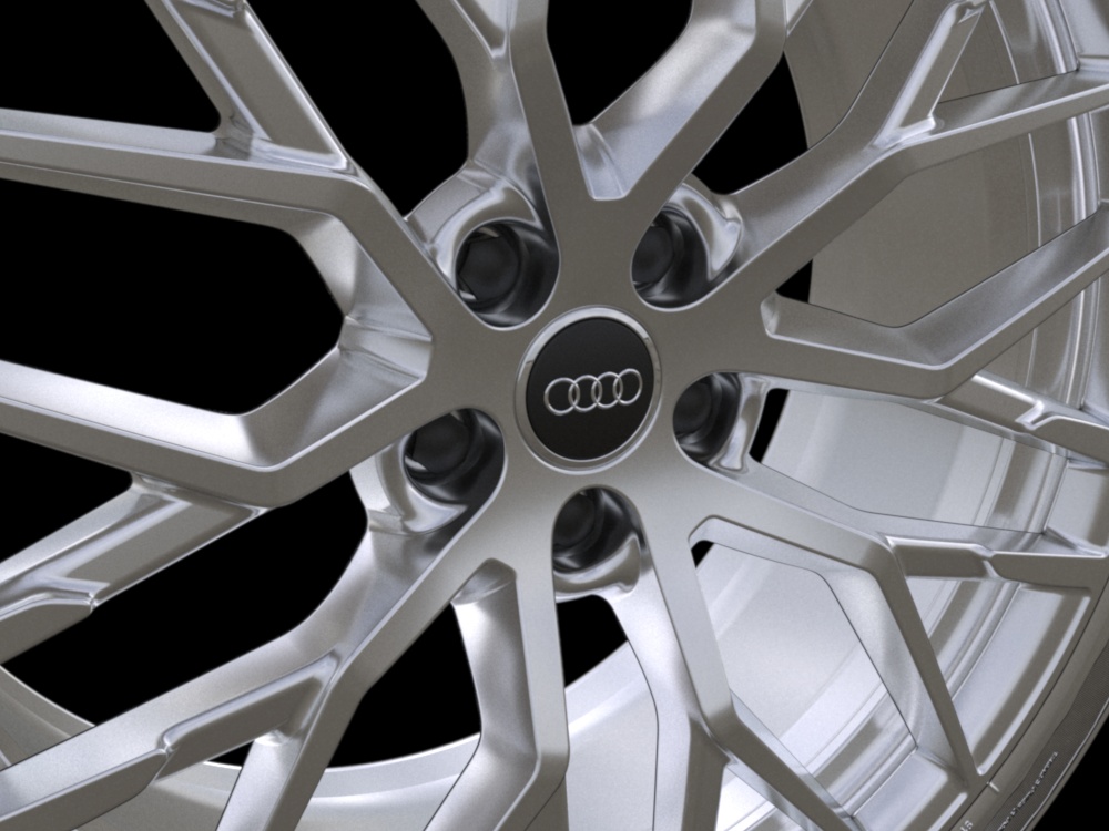

      I've always wondered though if theres a possibility or a way to use the VRayEdgesTex's rounded corner feature on CAD meshes which have a lot of internal triangles? WIll it work on only the outer edges somehow?
      Here are some images.
      The real wheel:
      The delivered geometry. Notice that there are two parts: The rim itself and the machined face. No fillet between them, just the sharp edge.
      Geometry rendered as is. Very flat and dull looking.
      The result with the new VrayEdgeTex. Straight out of the box, no additional modifactions. It even works between two different materials.
      It's magic, really!
