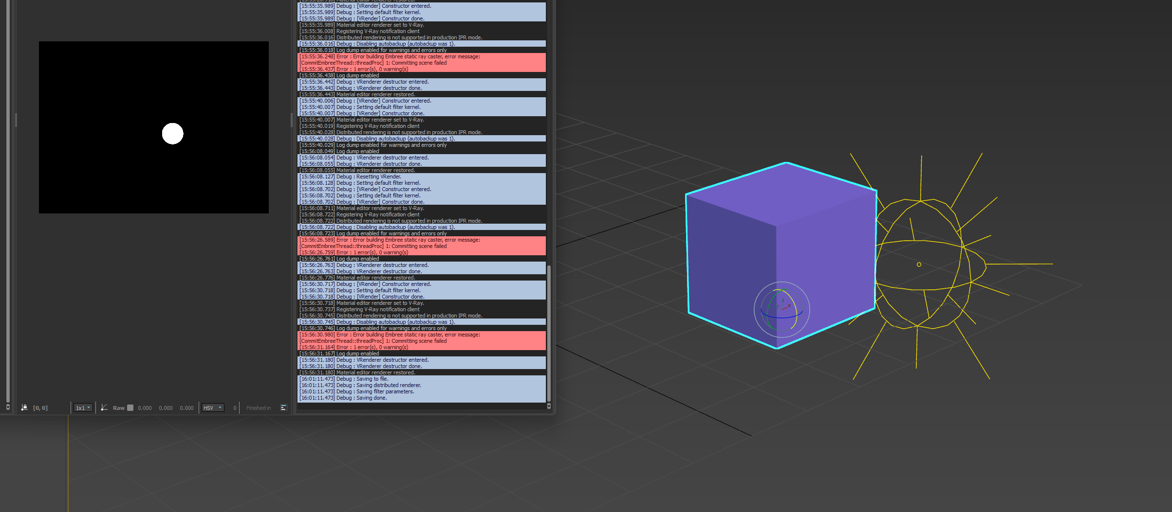

    I getting this whenever I try to use v-ray 7, CPU and GPU version
    [15:56:30.980] Error : Error building Embree static ray caster, error message: [CommitEmbreeThread::threadProc] 1: Committing scene failed
    [15:56:31.164] Error : 1 error(s), 0 warning(s)
    It happens wenever I add some geometry to the scene, for example a scene with one light renders fine, but when I try to add a box or sphere the render stops and shows this error
    v-ray 6 works fine

      Do you run the V-Ray 7 installation through some script or some other automated way ? In general we've seen this error on machines with quite old Microsoft Visual C++ Redistributable. By default V-Ray installation installs the required version and everything should work correctly.
      Can you try reinstalling V-Ray ?

        Hi,
        I have reinstalled V-Ray on both 3ds Max 2024 and 2025, but unfortunately, the issue persists. No automation scripts were used during the installation. I’ve ensured that all drivers, Windows updates, and 3ds Max itself are updated to their latest versions.
        Let me know if there’s anything else I should try.​
          Hm after installing V-Ray the redistributable is located in Program Files\Chaos\V-Ray\3ds Max 2025\utils - vc_redist.x64.exe - can you try installing it manually. Also try restarting the computer altogether.

            it worked! thanks

                Sorry to revive a thread from a few months ago, but we recently began having this same error on some of our studio machines.
                It actually seems like if you have the most recent version of the C++ redistributables installed (14.42.34433.0​) from something else pushing them, V-Ray 7 can start kicking this error. The version of the C++ redistributables that is with V-Ray 7 is older (14.40.33810). If you uninstall the newest version and install 14.40.33810, it works.
                That would make it seem like the error will begin repeating itself whenever the software that originally pushed the newest update forces it again.

                      i've just run into this same issue on my machine. since restarting this morning i can no longer render when there is any geometry in the scene.
                      [15:27:21.885] Error : Error building Embree static ray caster, error message: [CommitEmbreeThread::threadProc] 1: Committing scene failed
                      win11, ​C++ version is 14.40.33810 (which should be fine according to the post up thread...)

                        for anyone else experiencing this, updating to c++ 14.42.34438 seems to have fixed the problem.

                          we have started seeing this error on multiple machines in our studio on both 3ds max and sketchup.
                          both have the C++ version 14.42.34438 as above
                          both users affected were able to render this morning but are unable to now.
                          both can render an empty scene, but as soon as adding any geometry the render fails.
                          have updated to latest vray version for sketchup and 3ds max and restarted but still getting the same error message.
                          i am able to render the same scene on my machine without any issues.
                          to my knowledge there haven't been any updates pushed out to either machine.

                            we found a workaround by turning off embree in sketchup settings / optimisations
                            is there a way to disable embree in vray for 3ds max?
                            toggling 'conserve memory' has no effect.
                            looks like a new version of embree has been released by intel (v4.4.0) last week - might that be causing a conflict with Vray?

                              have also tried installing the latest stable nightly build 33051 for max 2024 but getting the same error.
