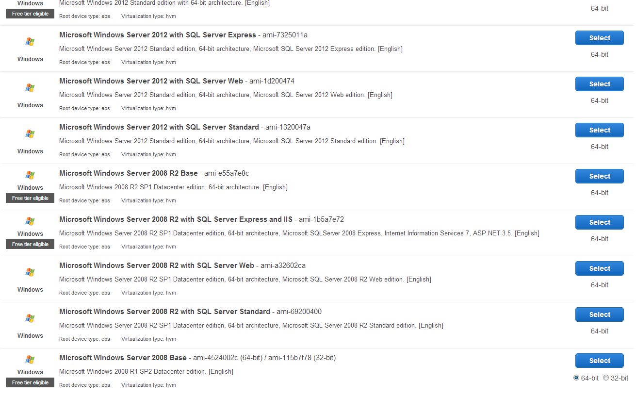

                          Originally posted by fraggle View Post
                          There is no Windows Based OS on this Amazon Service. Sorry there is finally, not on the front page but on the EC2 one.
                          You are probably using Maya and not max.
                          What Plan are you using?
                          Can you describe better how you set it up?
                          What are the 750H free for? 750H of rendering services free of charge? I have some doubt!
                          Thanks
                          Heya
                          1st ITS NOT RENDER SERVICE. Its computer RENTAL. You rent 1 computer. You set up windows and all. You save the image of that on ec2. You rent extra 10-20 pcs as many as you want and use saved image as window. So you have all settings and so on.
                          You pick computer with the power cpu/ram and then you rent them.
                          There is window, linux, red, and more. - attached image...Click image for larger version
                          750h of ec2 instance is basically a basic 1-2 core 600mb ram computer that you can rent to set up windows program and more for FREE. For 1 year.
                          I will eventually do a full on tutorial how to set it up and abuse.......
