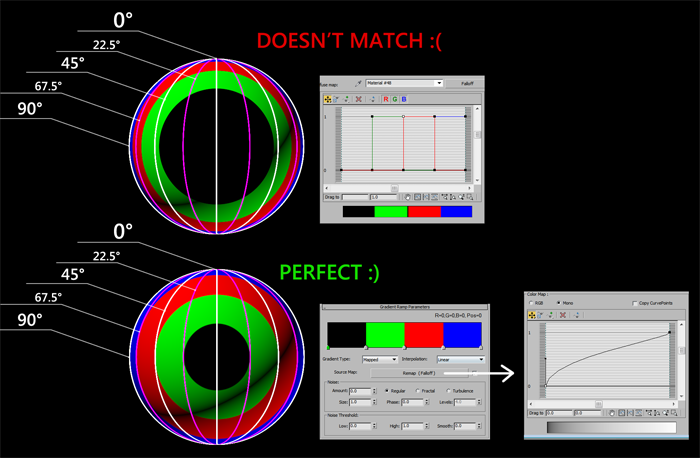

    So it was brought to my attention that Viscorbel had found a problem with the custom brdf method I've been teaching in the Mastering V-Ray course.
    You can read more here.
    http://viscorbel.com/vray-materials-part-3-metals/
    Image taken from his blog post:
    So I did some testing and I honestly expected the reflections to line up to the orientation of the lights (22.5* rotation) but they don't. Maybe I'm just tired and over thinking this, but from an orthographic camera, shouldn't these reflections line up and if they don't, is what Viscorbel trying to do physically correct?

    So after thinking about it for a second I realised it's because the thickness of the sphere offsets the angle at which the ray hits the surface.
    Just need confirmation that the 3dsMax Falloff map does work linearly and everything is correct.

      I've just tried this and I get the same result as Viscorbel.
      Correct me if I'm wrong but you are expecting the falloff map to return RGB 128 at 45 degrees. It appears that it actually returns RGB 76.
      I've attached a couple of images and a Max 2014 scene if anyone else want to check.

        The falloff map is not linear, the correction curve to linearize it looks roughly like the attached image.
        Seems that 3ds max uses some math behind the scenes to distort it for some reason.
          Does that curve look a tiny bit srgb-ish?
            The Falloff map works with the cosine of the angle, and not with the actual angle. The curve that viscorbel shows above is the graph of its inverse (the arccos function).
