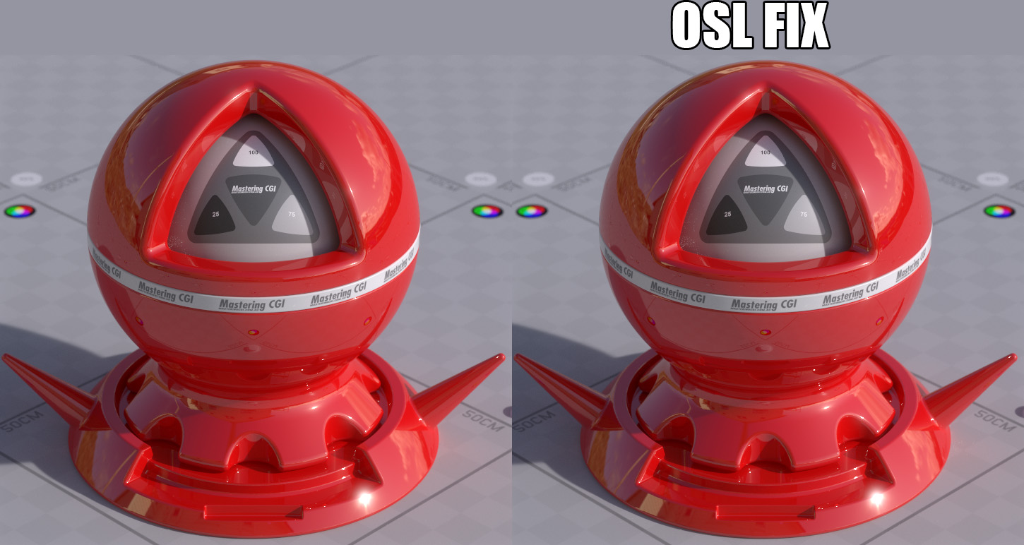

          Now, could someone also show the difference this has on a material? Just curious to know if this was all worth it
            It was worth it!

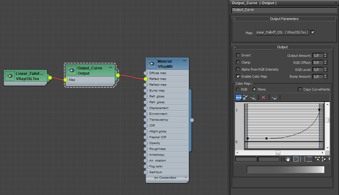

                          That should be something like this:
                          OSL-Texture -> Output-Map -> Reflection-Color of VRay-Material
                          Since the OSL-Shader is like a Falloff-Map, just with a linear Falloff, there is no need to plug this into a Falloff-Map again. Of course, as Viscorbel mentioned, it makes sense when updating old materials which already have a custom curve in the Falloff-Map.
