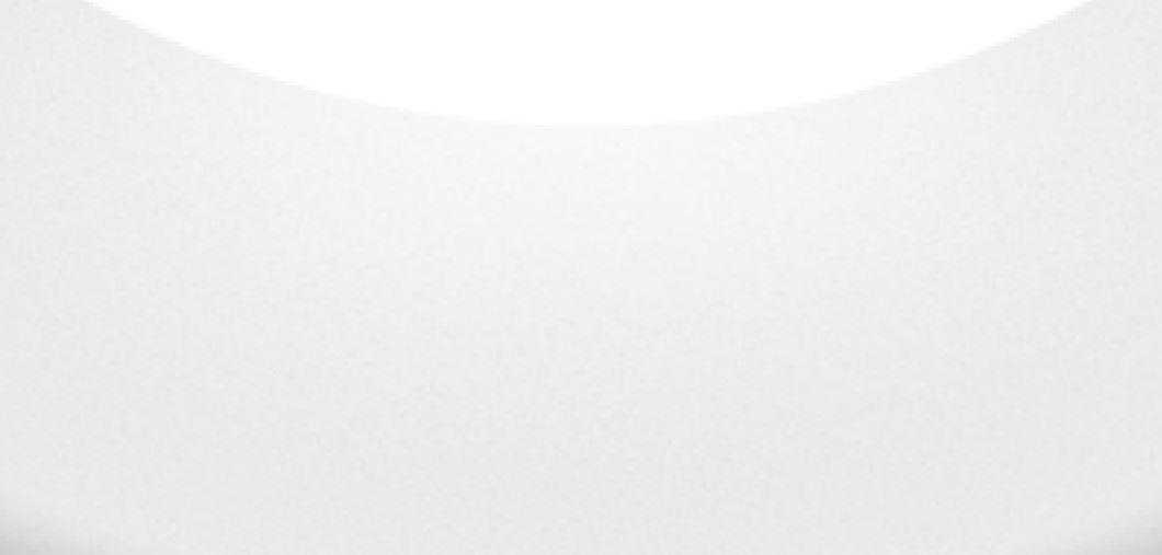

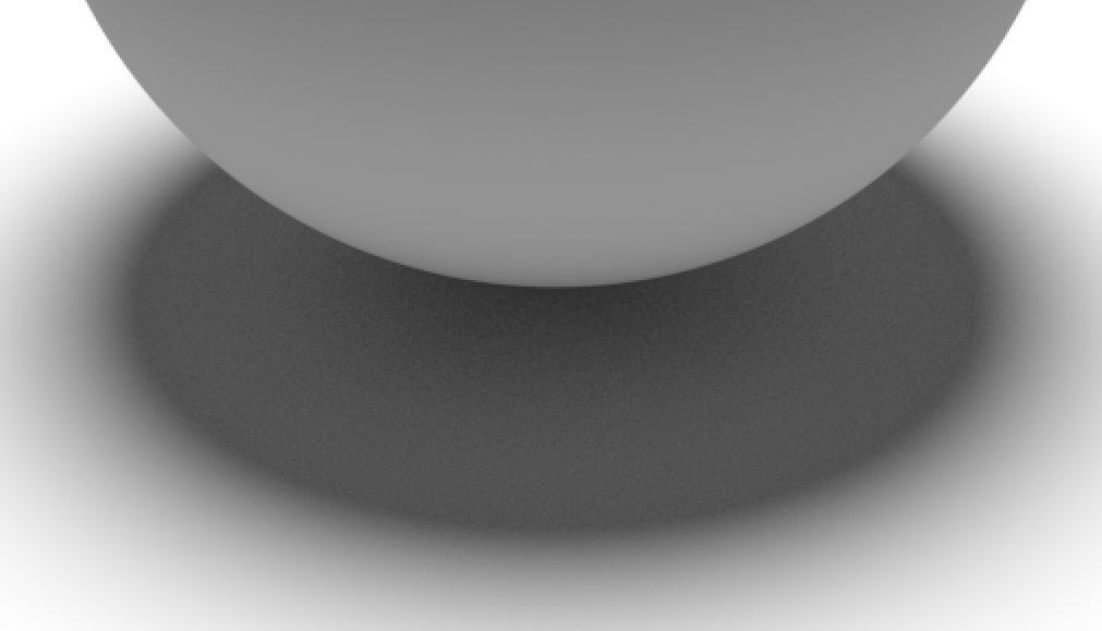

        Here is an example of that problem: I rendered an image with an alpha based on direct Shadow from a sphere onto a matte plane. For the purposes of demonstration, I used very noisefree settings. But on a white background, you can see how the shadow, because of the alpha is pretty noisy.

        200% zoom, so you can better see the grain:
        Click image for larger version  Name:	GrainyShadowZoom200percent.JPG Views:	0 Size:	21.8 KB ID:	1141184
        200% Zoom Alpha:
        Click image for larger version  Name:	GrainyAlphaZoom400percent.JPG Views:	0 Size:	10.5 KB ID:	1141183
        However, the shadow does become very smooth, if you raise the min subdivs. I took a screenshot of that, as well and you can see how the shadow is basically noise free. So it seems like the system always uses min subdivs when calculating the alpha of the shadow, regardless of noise threshold settings
        Here is the shadow at 200% again and even zoomed in, it looks very smooth.
        Click image for larger version  Name:	HighSubDivs200percent.JPG Views:	0 Size:	36.4 KB ID:	1141185

              I see. Sorry to say, this is a common issue with shadow catchers. Though it's barely visible, the alpha noise pattern still matches the RGB, though it's barely visible (check RGB values). Using a VRayDenoiser should give you the desired look without the render time cost of increasing the image sampler settings.

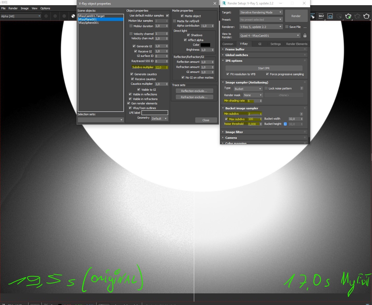

                  Well, I think if you may try settings like this, it could serve its purpose also being a bit faster and without using denoising.
                  What I never saw before, was a strange gap in the shadow in your original scene (left side), which turned out to disappear while using more samplings.
                  Decreasing the NoiseTheshold to 0,02 e.g. gives a even faster rendering (11,3 sec), while leaving the shadow even not to noisy.
                  If you now turn a denoiser on that ( I tried the Intel one) you get a ultrasmooth shadow.
