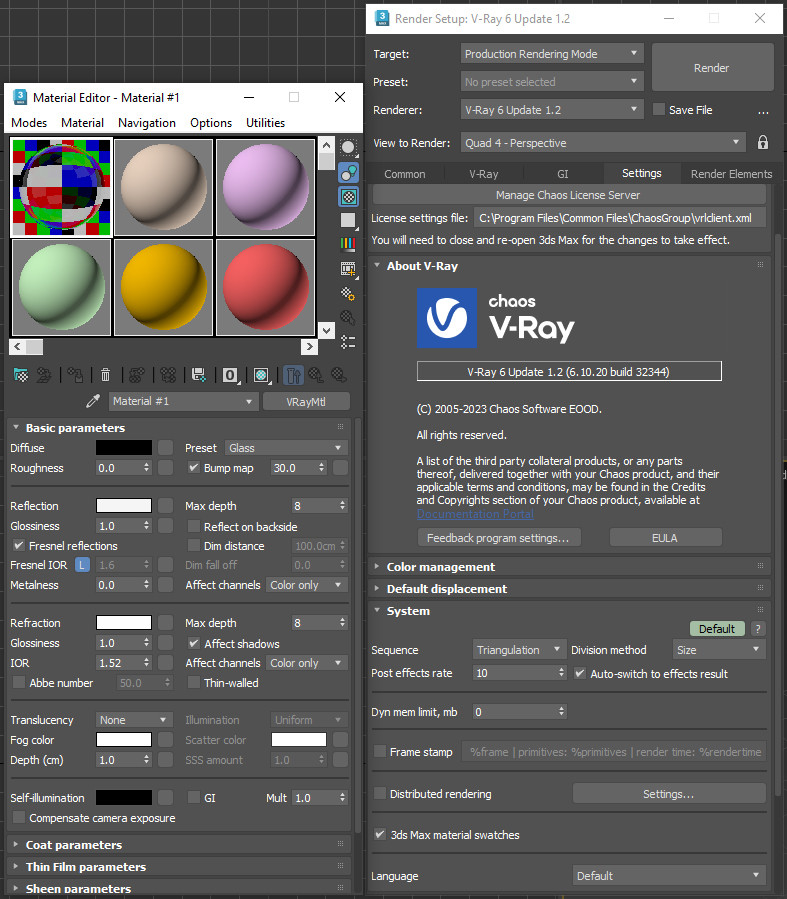

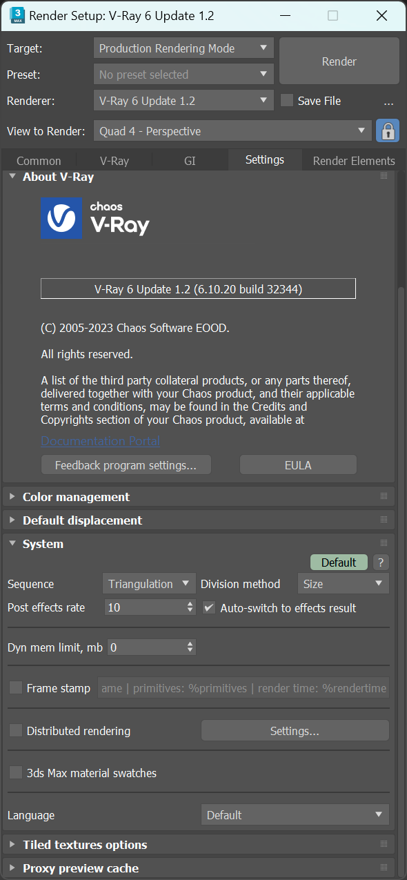

                      I am experiencing the same problem on 3ds max 2024.1 (update to 2024.2 didn't help) and v-ray nightlies vray_adv_61020_max2024_x64_32279 (update to vray_adv_61020_max2024_x64_32344 didn't help). It did work until end of last week without any problems though...
                        Nevermind, my bad. I must have accidentally enabled the "3ds max material swatches" in the render setup > settings > system
                        DCHA34 DId you check if that's enabled for you as well?

                            Sure:
                            ​​ Click image for larger version  Name:	grafik.png Views:	0 Size:	313.0 KB ID:	1195528
                            Click image for larger version  Name:	grafik.png Views:	0 Size:	80.1 KB ID:	1195531
                            • #15
                              Here are my screenshots. Is this correct? I'm not sure.
