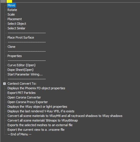

    So after installing Vray6 the default long list of Vray assets when you right click is gone and now you just have object properties. I went ahead and manually added all the things Vray5 had on its list, however everytime I reopen 3d max it resets to default. Seems like Vray is overriding 3d maxs defaults?
    The quads options now have their own section in the V-Ray menu (V-Ray>VFB/Exporters/Converters). Otherwise, I tried adding some of the options in the quads menu and they are saved properly. The renderer has to be V-Ray to see them, though.

      Attached is a visual of how I am setting them up to be which is somehow not saving. I honestly am not sure why, I also know when I click the "Vray Menu Registration" button, it also makes all the options go away besides the object properties.

                  I was referring to the main 3ds max toolbar (check screencap).
                  Originally posted by RedStar View Post
                  After you mentioned the Quads do save on your end I went and tried to add them on another workstation here at the office. Sadly same situation, as soon as I restart max it goes back to default setup where the only Vray option I have when I right click is "Vray Properties",
                  Yes, that's the menu I'm using. The reset happens because of the V-Ray menu registration function you're using. It resets the menu to it's current default (which is without those options).
