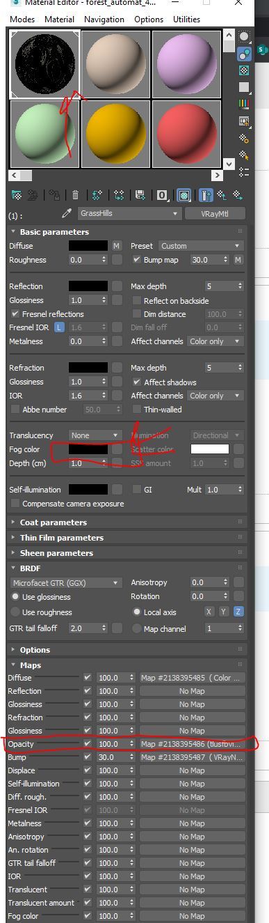

                  So I looked at some of my other heavy FP scene files and they seem to be fine as well. No idea why some of my other assets got weird. I did however figure out what is causing the opacity slot not to work. Its the "Fog Color". Somehow on the files with issues, the fog color is black instead of white.

                    Originally posted by RedStar View Post
                    ...Somehow on the files with issues, the fog color is black instead of white.
                    That's something that can easily be scripted, or solved with MMZorb. But still...it's annoying.
                      I did however figure out what is causing the opacity slot not to work. Its the "Fog Color". Somehow on the files with issues, the fog colour is black instead of white.
                      So the fog colour changed when you opened the scenes with newer versions?

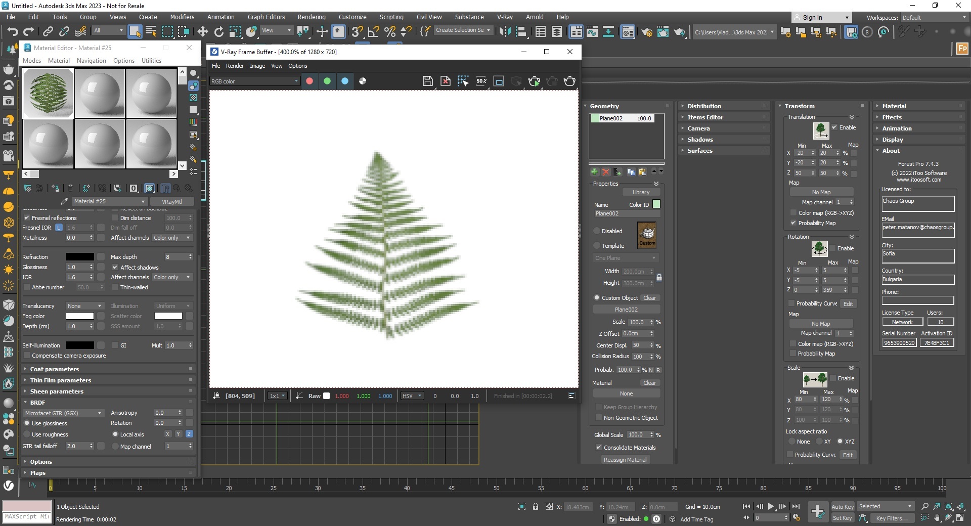

                      I tested a simple scene with a leaf (opacity) and latest versions of V-Ray and Forest Pack but everything seems fine. However if I set the fog colour to black, the opacity affected areas then renders black but this is expected.
                      Click image for larger version  Name:	3dsmax_2022-07-25_14-09-10.jpg Views:	0 Size:	415.5 KB ID:	1155035Click image for larger version  Name:	3dsmax_2022-07-25_14-09-58.jpg Views:	0 Size:	417.3 KB ID:	1155036
