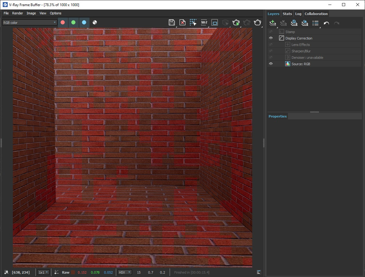

    DR the following scene (max2024) to see the bucket artefact.
    https://drive.google.com/file/d/1sby...ew?usp=sharing
    Both host and server are using V-Ray 6.20.03 (Same for Nightlies and Official 6.20.02) + 3dsMax 2024.2.1.
    It looks like there is a problem with the GI.
    Adaptive Light is disabled, Adaptivity clamp 100 etc. have no effect.
    What is the cause?​

    Hi, thanks for posting. The box is overlapping the wall and this is causing buckets.
    Click image for larger version  Name:	3dsmax_2024-03-13_11-10-10.jpg Views:	0 Size:	292.6 KB ID:	1204318
    It is a rule of thumb to avoid overlapping faces.
    In this example it is very curious since it one slave is rendering one of the overlapping faces and the other slave is rendering the other.

                    Hi again, I did a bit more testing with your scene.
                    The way you have sent it, it has no bitmap textures and does not reproduce buckets.
                    If we add a bitmap to the wall material it renders with buckets:
                    This is the same bug reported here.
                    If your client has buckets with the same exact scene that you've originally uploaded in post #6 then they may have some other issues.
