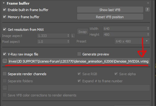

                        I tested again Nvidia and Intel denoisers with the latest V-Ray 6.20.06
                        I've set them to generate elements only:
                        Click image for larger version  Name:	3dsmax_2024-04-22_12-48-17.jpg Views:	0 Size:	39.2 KB ID:	1207061
                        The render output is vrimg:
                        Click image for larger version  Name:	3dsmax_2024-04-22_12-49-11.jpg Views:	0 Size:	42.1 KB ID:	1207062
                        After rendering is complete I started the Denoiser Tool
                        Click image for larger version  Name:	chrome_2024-04-22_12-51-01.jpg Views:	0 Size:	91.3 KB ID:	1207063Click image for larger version  Name:	explorer_2024-04-22_12-51-49.jpg Views:	0 Size:	97.7 KB ID:	1207064
                        All frames are successfully denoised. I haven't tested with .exr instead of vrimg as output format.
