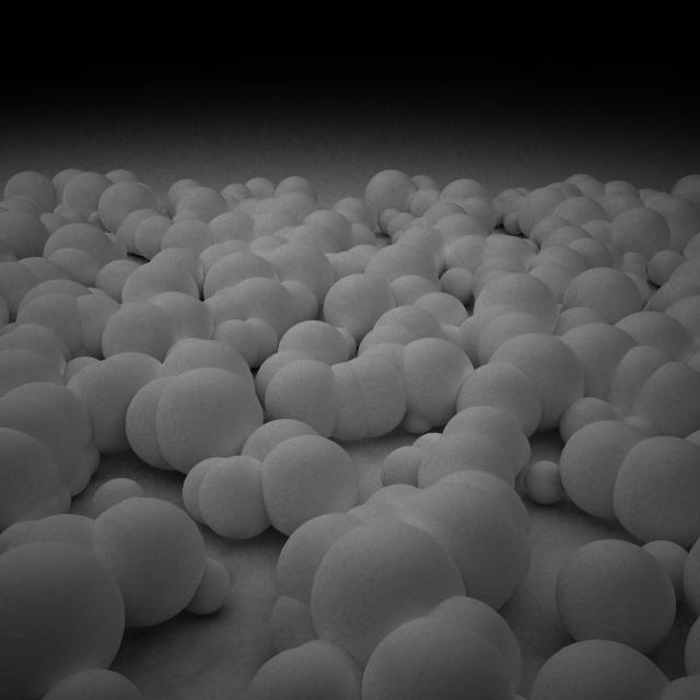

        have now tried once more with a simple scene and precomputed gi-file. when rendering on the singlepc everything is fine - when i switch to dr i got these different looking buckets ....
