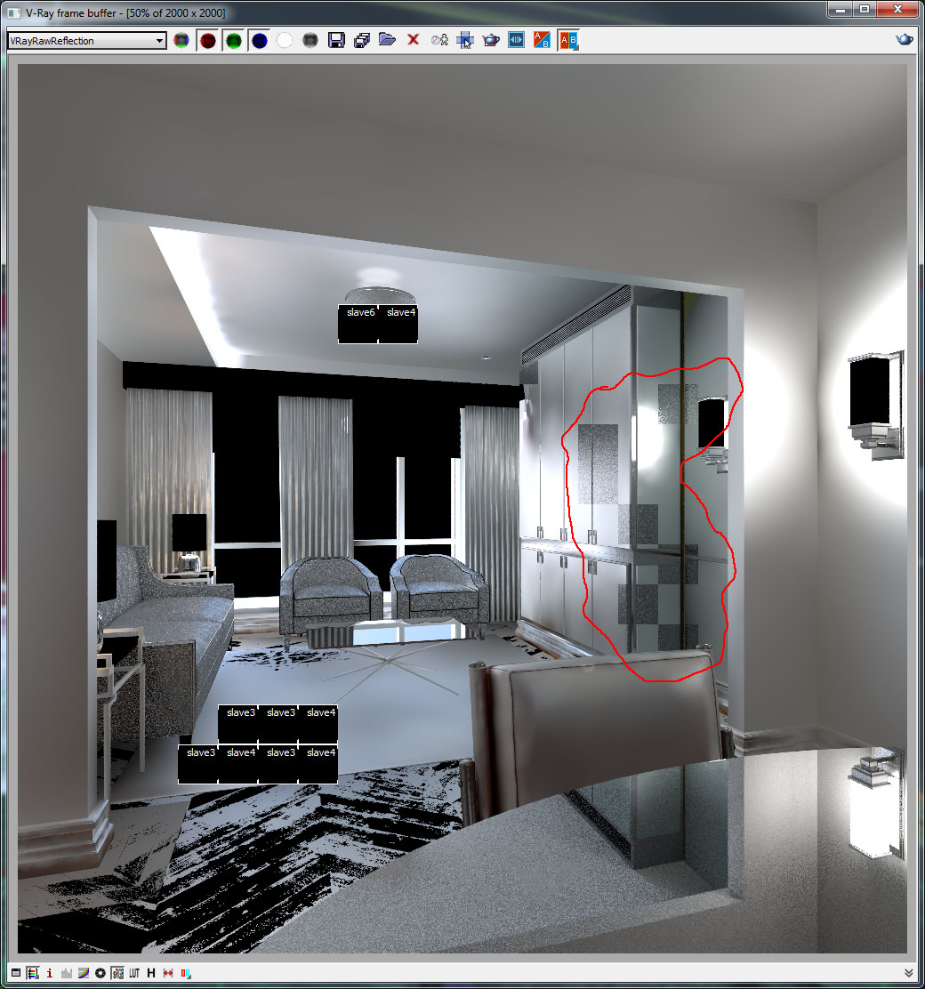

    I'm performing a DR and buckets from my local machine are paler than the rest. It seems only to be visible on certain objects, for example, in the attached, on the gold metal picture frames. To be honest, I'm not sure if my local machine is rendering correctly and the slaves are wrong, or vice versa.
    What's going on here?

                It seems to be something with the reflection channel. See here:-
Name:	rgb render.jpg
ID:	850229Click image for larger version
                The problem buckets are my local machine (unless all the other machines are wrong and my local machine is right)
