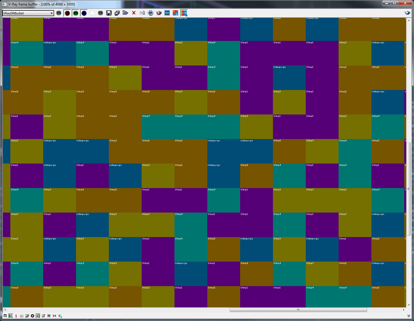

    Don't think so. As far as I know everything is the same. Here's another project exhibiting the same problems:-
Name:	bucket ref problem buckets.jpg
ID:	850300Click image for larger version
Name:	bucket ref problem reflection.jpg
ID:	850301Click image for larger version
Name:	bucket ref problem rgb.jpg
    Its just my local machine cocking things up. Any chance I could send this file to Chaosgroup to figure out what's happening?

          That's weird. Its almost as if your pc can't see the HDRI map, but the slaves can, which doesn't make sense. My guess would also be different service packs or vray builds.
          Also check that ALL machines have the decimal setup as a . (point) and not a , (comma)
          In Windows 8 they decided to change the default to comma instead of point
          Kind Regards,
          Morne
          • #20
            Probabely that´s not the problem you have but there is also one other thing that makes only your workstation render different.
            If you have an object with a modifier stack selected and any other modifier than the last one in this stack is selected, while show end result
            is turned "off" it will render different only on your machine. For example when you have a sphere with an uvw map, the sphere is selected
            but in the modifier stack the sphere below the uvw map is selected. It will render just on your machine without the uvw map while all the slaves
            render with the uvw modifier.

                Sorry about that. I did upload the files but then the problem went away. However, a short while later (that same day!), when working on the same scene, the problem re-surfaced. I was in the act of updating our ticket, but we have found it is happening more and more in pretty much all of our projects. I believe it is related to using solidrocks, but I can't be absolutely sure. I have since started using a different method for rendering which is far more manual - using LC and BF, and for the moment, the problems seem to have gone away.
                When I have more time, I will try and follow this up, but my gut feeling at the moment is that Solidrocks is doing something weird that freaks out locally rendered buckets.
