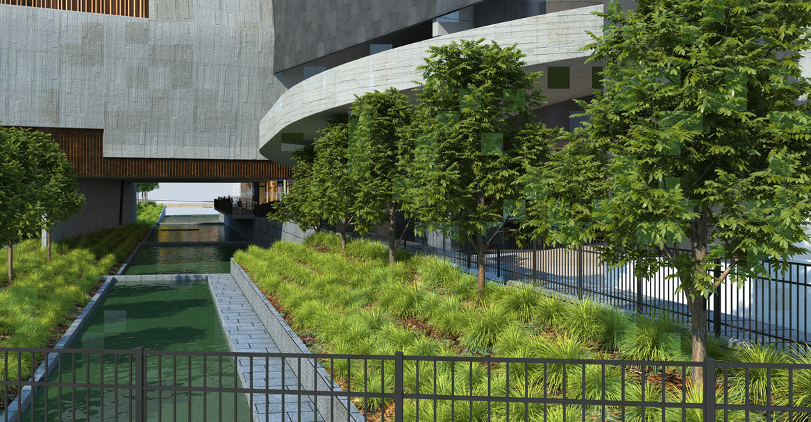

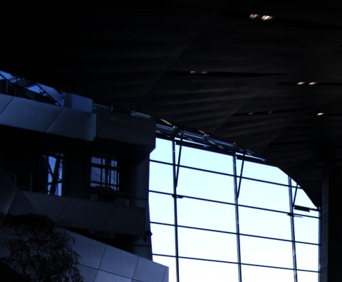

                                Here are some pictures of this test.
                                Pic 1 shows how it renders with gamma settings off
                                Pic 2 shows the rendering with gamma settings on and gamma set to 1.0 It´s a screenshot
                                because once saved gamma correction is applied and it looks like pic 1.
                                Pic 3 (not a screenshot) shows the wrong buckets. If you compare the darker buckets to pic 2 you will notice they are exactly the same
                                Maybe that helps hunting down this bug.
