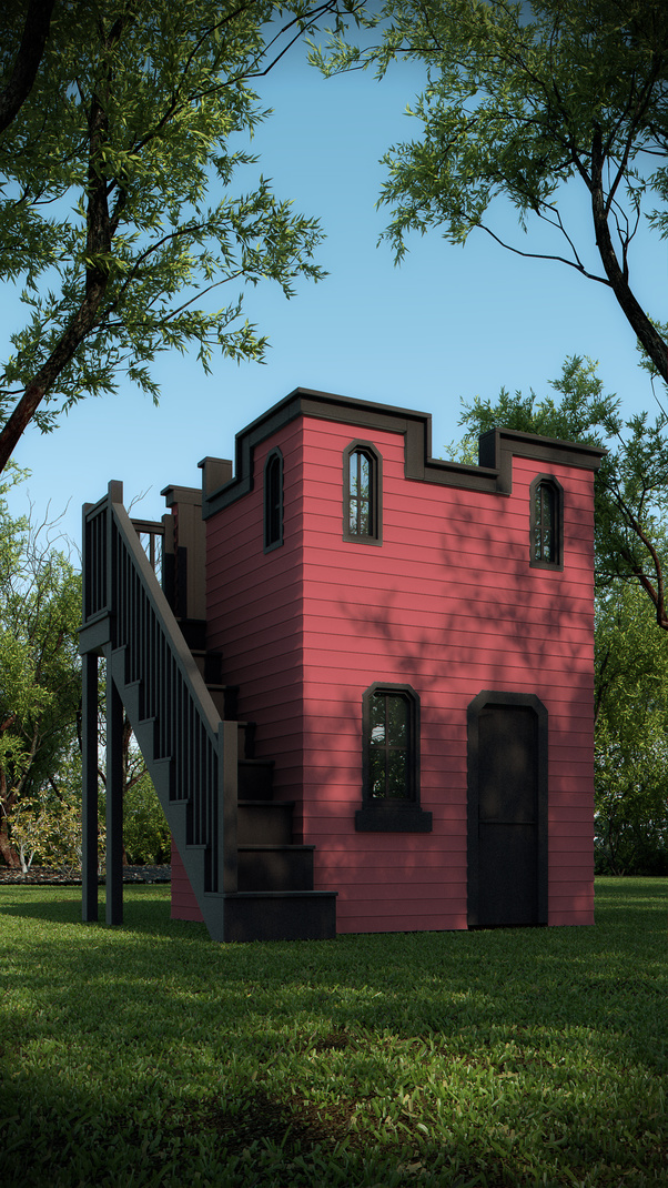

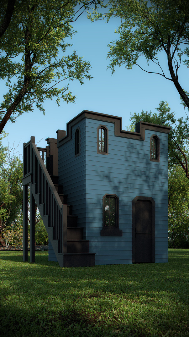

                I worked the displacement out, thanks to you guys, but I am getting a strange light leak around the corner. Anyway, here it is.

                  retrace thresh on? geo shelled?

                    it's not shelled and I am not sure if I had retraced thresh on. I typically don't turn it on unless I get light leaks. This, to me, wasn't really a light leak. You can't really see it in these images, unless you zoom in, so I am probably good.

                      yeah looks a bit weird, almost like low subdivision in displacement. Your vegetation also cg?

                        Yes. everything is CG. I have things subdivided pretty good, but I can try to push it some more
